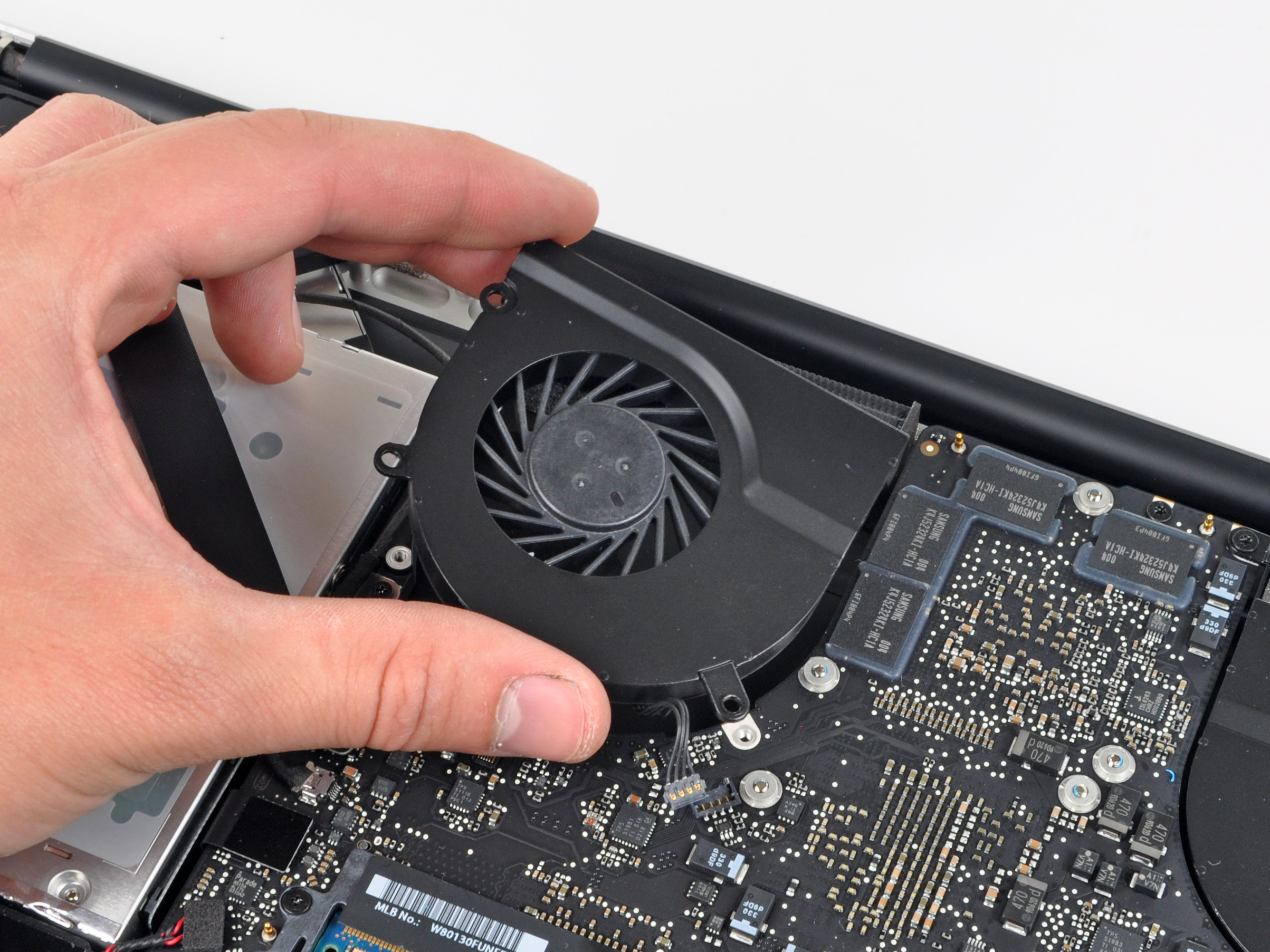

Replacing a defective fan is pretty easy and will keep your laptop running cool.

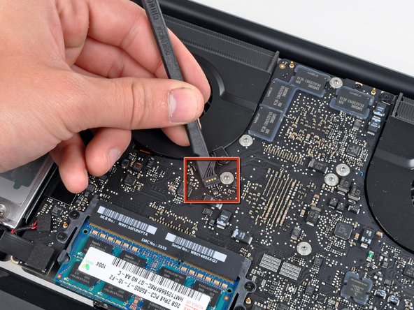

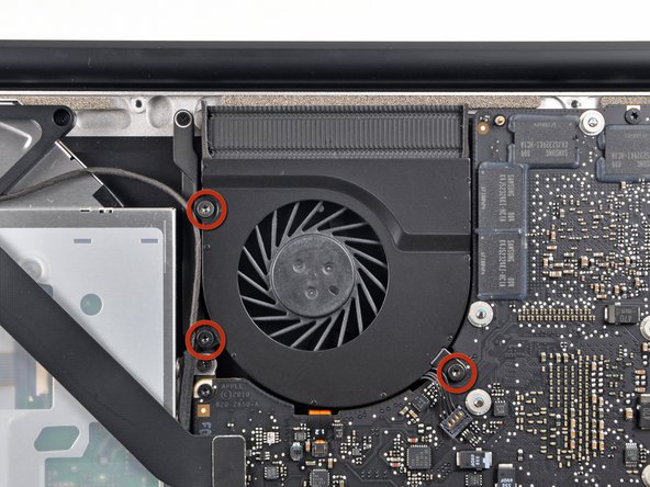

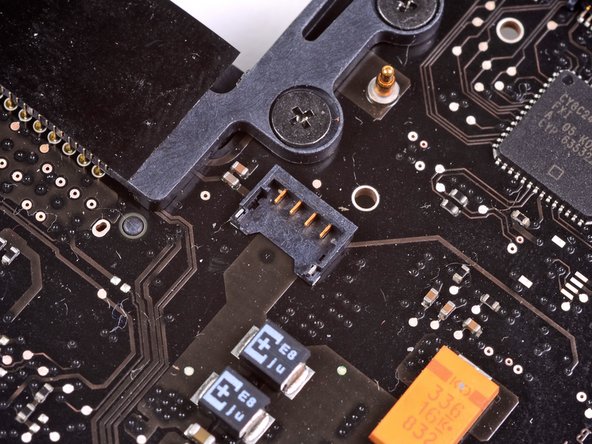

Remove three T6 Torx screws securing the right fan to the logic board and upper case.
