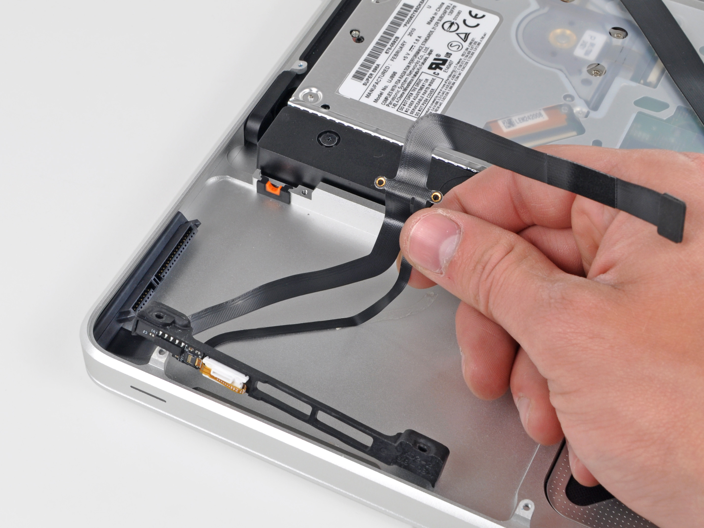

Installing MacBook Pro 15" Unibody Mid 2010 Hard Drive/IR Sensor Cable
Replace the hard drive/IR sensor cable on your MacBook Pro 15" Unibody Mid 2010.
  • Add Note x
  • x 9
The hard drive cable also contains the IR sensor/sleep indicator.

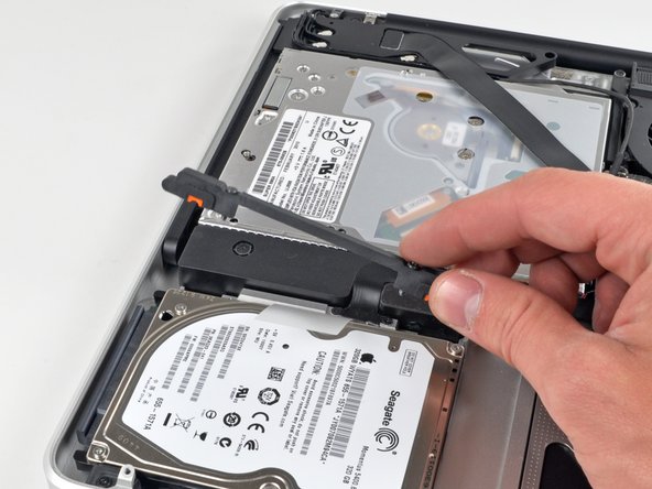

Add Note Edit Step 7 — Hard Drive  ¶
  • Remove two Phillips screws securing the hard drive bracket to the upper case.
  • These screws are captive to the hard drive bracket.
Image #1
Add Note Edit Step 8  ¶
  • Lift the the retaining bracket out of the upper case.
