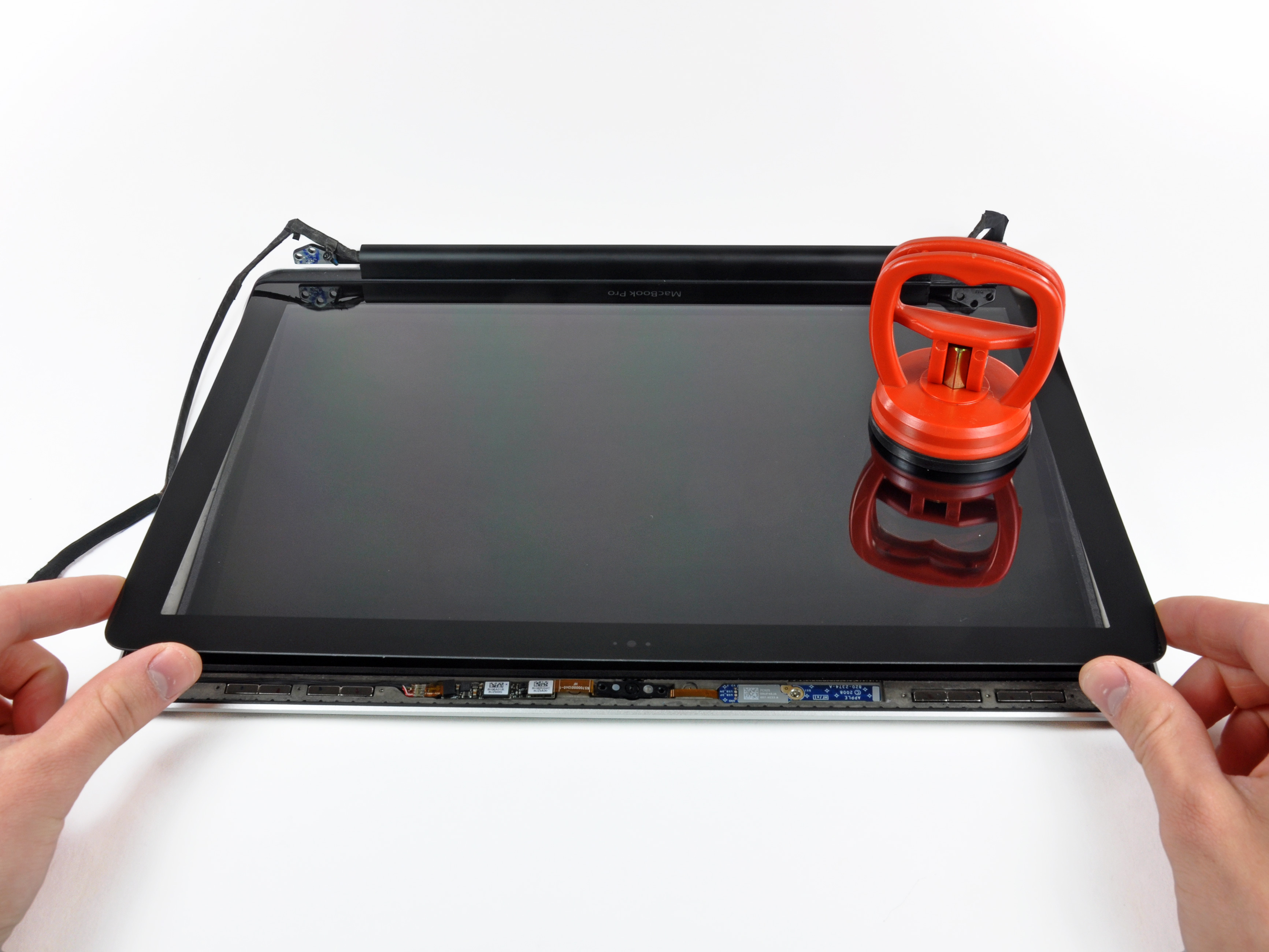

Use this guide to replace a broken front display glass panel. Removal of the front display glass is required to access the LCD. Although it is not technically necessary to remove the display to access the front display glass, it greatly simplifies the task. This guide is not applicable for anti-glare displays.

  • Using both hands, lift the lower case near the vent to pop it off two clips securing it to the upper case.
