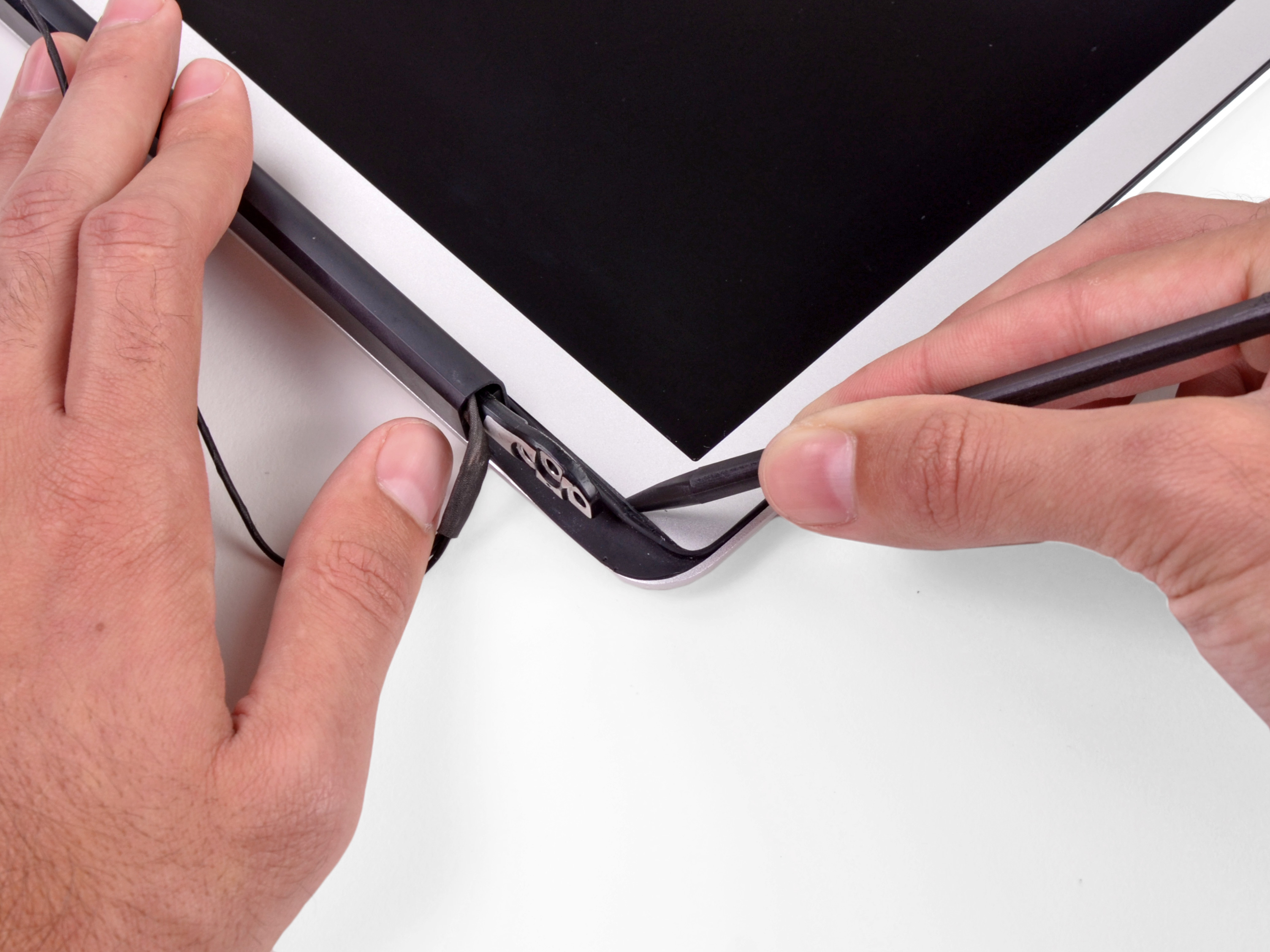

Add Note Edit Step 7 — Display  ¶
  • Use the flat end of a spudger to carefully pry the AirPort/Bluetooth ribbon cable up off its socket on the logic board.
Image #1
Add Note Edit Step 8  ¶
  • Pull the camera cable connector straight out of its socket on the logic board.
  • Pull the cable parallel to the face of the logic board toward the optical drive opening.
