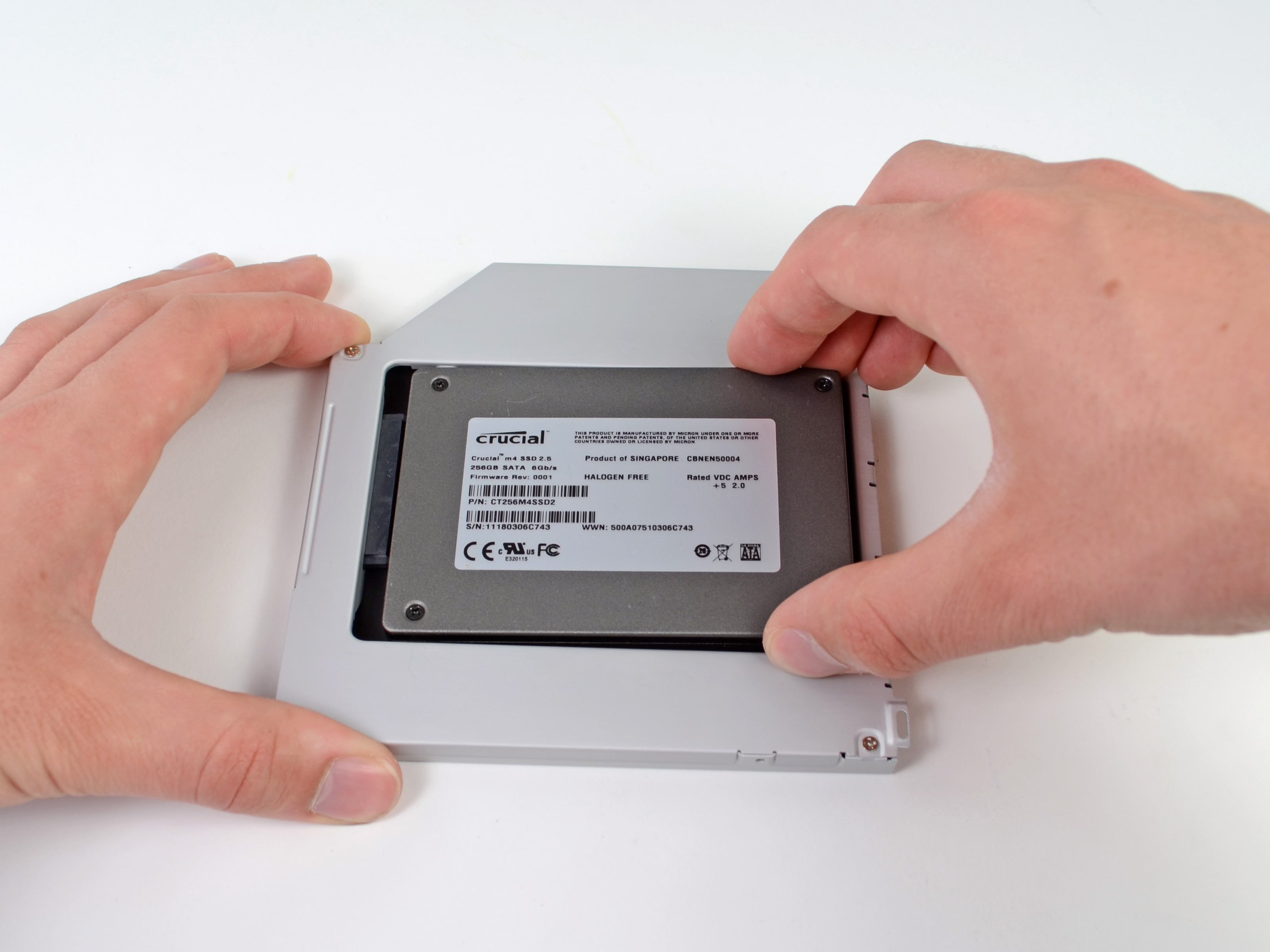

  15. Installing MacBook Pro 15" Unibody Mid 2010 Dual Hard Drive, Dual Hard Drive: step 15, image 1 of 2 Installing MacBook Pro 15" Unibody Mid 2010 Dual Hard Drive, Dual Hard Drive: step 15, image 2 of 2
    • Remove the plastic spacer from the optical bay hard drive enclosure by pressing in on one of the clips on either side and lifting it up and out of the enclosure.
  16. Installing MacBook Pro 15" Unibody Mid 2010 Dual Hard Drive: step 16, image 1 of 3 Installing MacBook Pro 15" Unibody Mid 2010 Dual Hard Drive: step 16, image 2 of 3 Installing MacBook Pro 15" Unibody Mid 2010 Dual Hard Drive: step 16, image 3 of 3
    • Make sure that the hard drive connectors are facing down before placing it into the enclosure.
    • Gently place the hard drive into the enclosure's hard drive slot.
    • While firmly holding the enclosure in place with one hand, use your other hand to press the hard drive into the enclosure connectors.
  17. Installing MacBook Pro 15" Unibody Mid 2010 Dual Hard Drive: step 17, image 1 of 2 Installing MacBook Pro 15" Unibody Mid 2010 Dual Hard Drive: step 17, image 2 of 2
    • Once the hard drive is snug, reinsert the plastic spacer while holding the hard drive against the bottom of the enclosure.
  18. Installing MacBook Pro 15" Unibody Mid 2010 Dual Hard Drive: step 18, image 1 of 2 Installing MacBook Pro 15" Unibody Mid 2010 Dual Hard Drive: step 18, image 2 of 2
    • Use two Phillips #1 screws to secure the drive to its enclosure.
  19. Installing MacBook Pro 15" Unibody Mid 2010 Dual Hard Drive: step 19, image 1 of 1
    • Attach the optical drive bracket to the new enclosure with two Phillips #0 screws.
    • Reconnect any cables you have removed from the original optical drive onto the optical bay enclosure.
