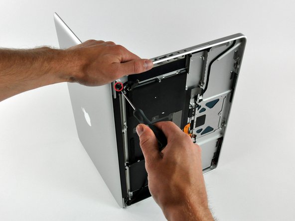

  • Be sure to hold the display and upper case together with your other hand. Failure to do so may cause the freed display/upper case to fall, potentially damaging each component.
  • Remove the last remaining 6 mm Torx screw securing the display to the upper case.

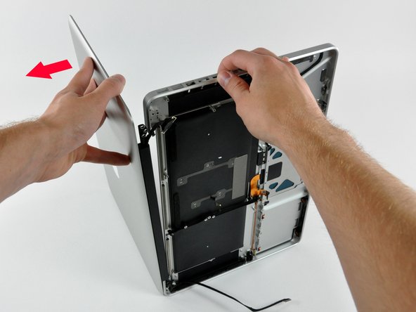

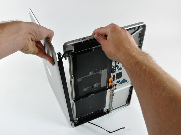

Image #1 Image #2 Image #3
Add Note Edit Step 42  ¶

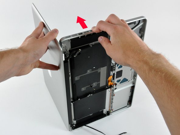

  • Grab the upper case with your right hand and rotate it slightly toward the top of the display so the upper display bracket clears the edge of the upper case.
  • Rotate the display slightly away from the upper case.
  • Lift the display away from the upper case, minding any brackets or cables that may get caught.
