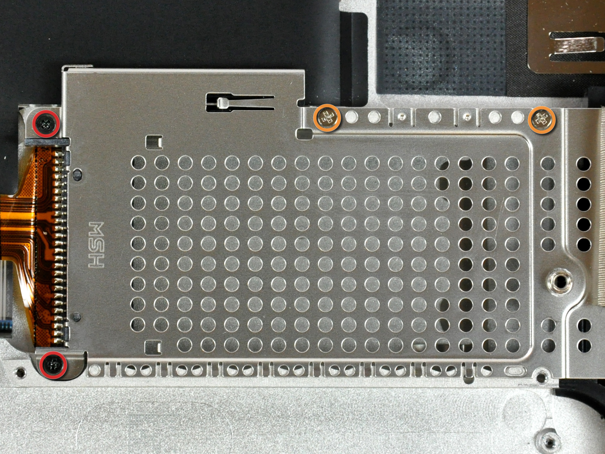

Add Note Edit Step 6 — Mid Wall  ¶
  • Remove the following 5 screws securing the mid wall to the upper case:
    • Three 10.5 mm Phillips screws.
    • Two 3.7 mm Phillips screws.
Image #1
Add Note Edit Step 7  ¶
  • Lift the mid wall out of the upper case.
