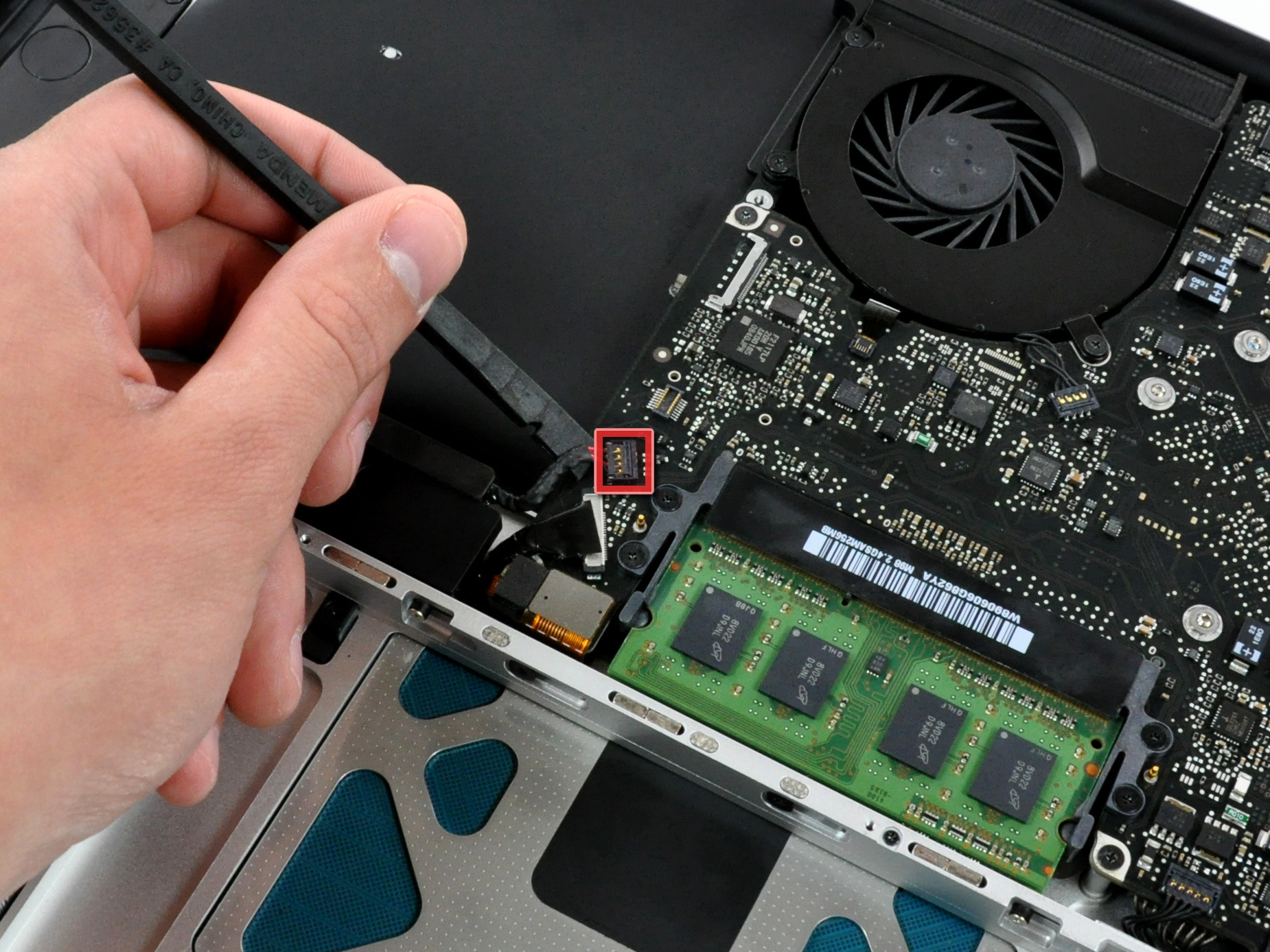

Add Note Edit Step 6 — Optical Drive  ¶
  • Disconnect the camera cable by pulling the male end straight away from its socket.
Image #1
Add Note Edit Step 7  ¶
  • Deroute the camera data cable from the channel in the optical drive.
Image #1
Add Note Edit Step 8  ¶
  • Use a spudger to pry the optical drive connector straight up off the logic board.
