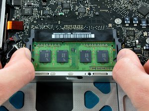

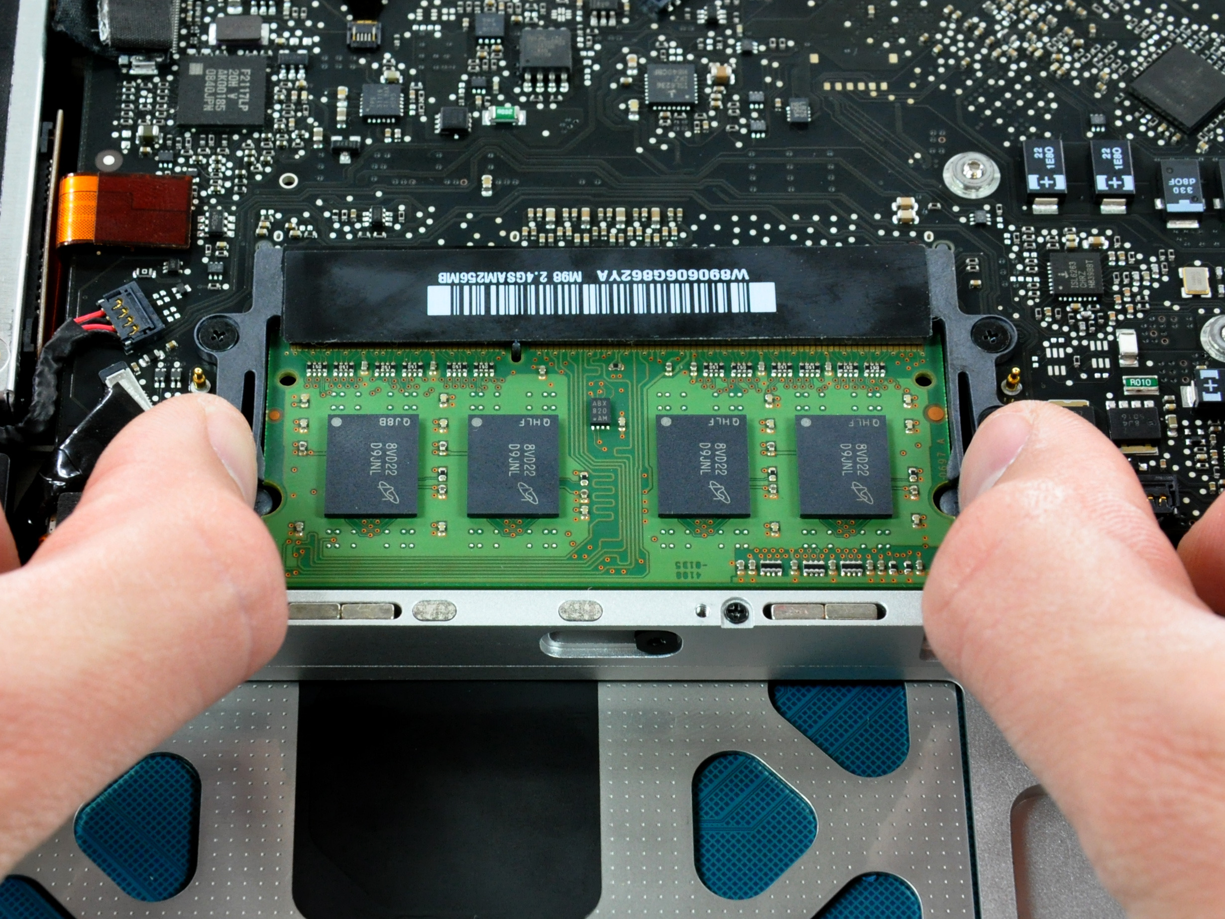

  6. MacBook Pro 15" Unibody Late 2008 and Early 2009 RAM Replacement, RAM: step 6, image 1 of 1
    • Release the tabs on each side of the chip by simultaneously pushing each tab away from the RAM.
    • These tabs lock the chip in place and releasing them will cause the chip to "pop" up.

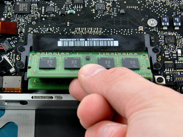

  7. MacBook Pro 15" Unibody Late 2008 and Early 2009 RAM Replacement: step 7, image 1 of 1
    • After the RAM chip has popped up, pull it straight out of its socket.
    • Repeat this process if a second RAM chip is installed.
