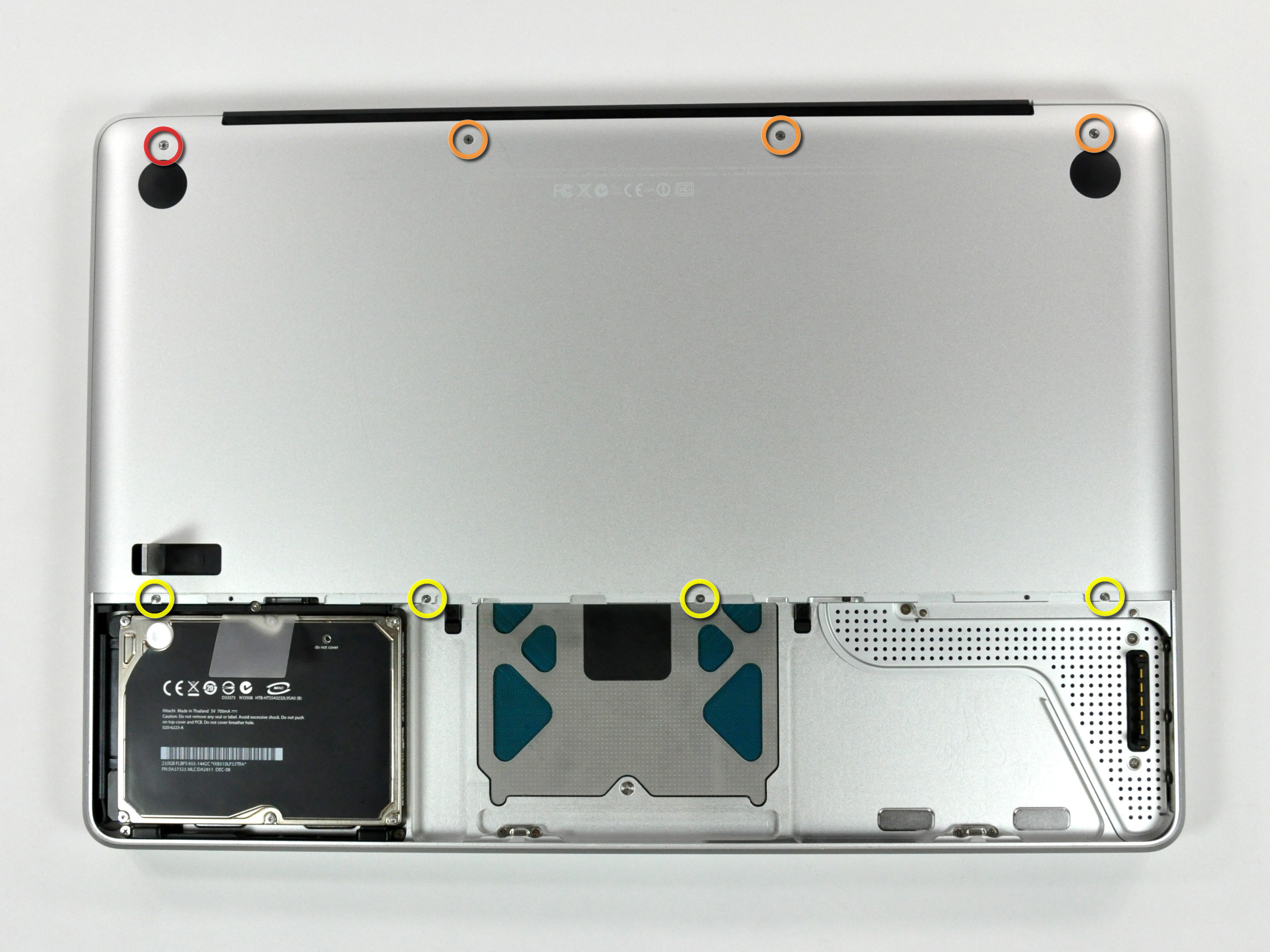

Add Note Edit Step 4 — Lower Case  ¶
  • Remove the following eight screws securing the lower case to the chassis:
    • One 5.4 mm Phillips screw.
    • Three 14 mm Phillips screws.
    • Four 3.5 mm Phillips screws.
Image #1
Add Note Edit Step 5  ¶
  • Using both hands, lift and remove the lower case off the upper case.
