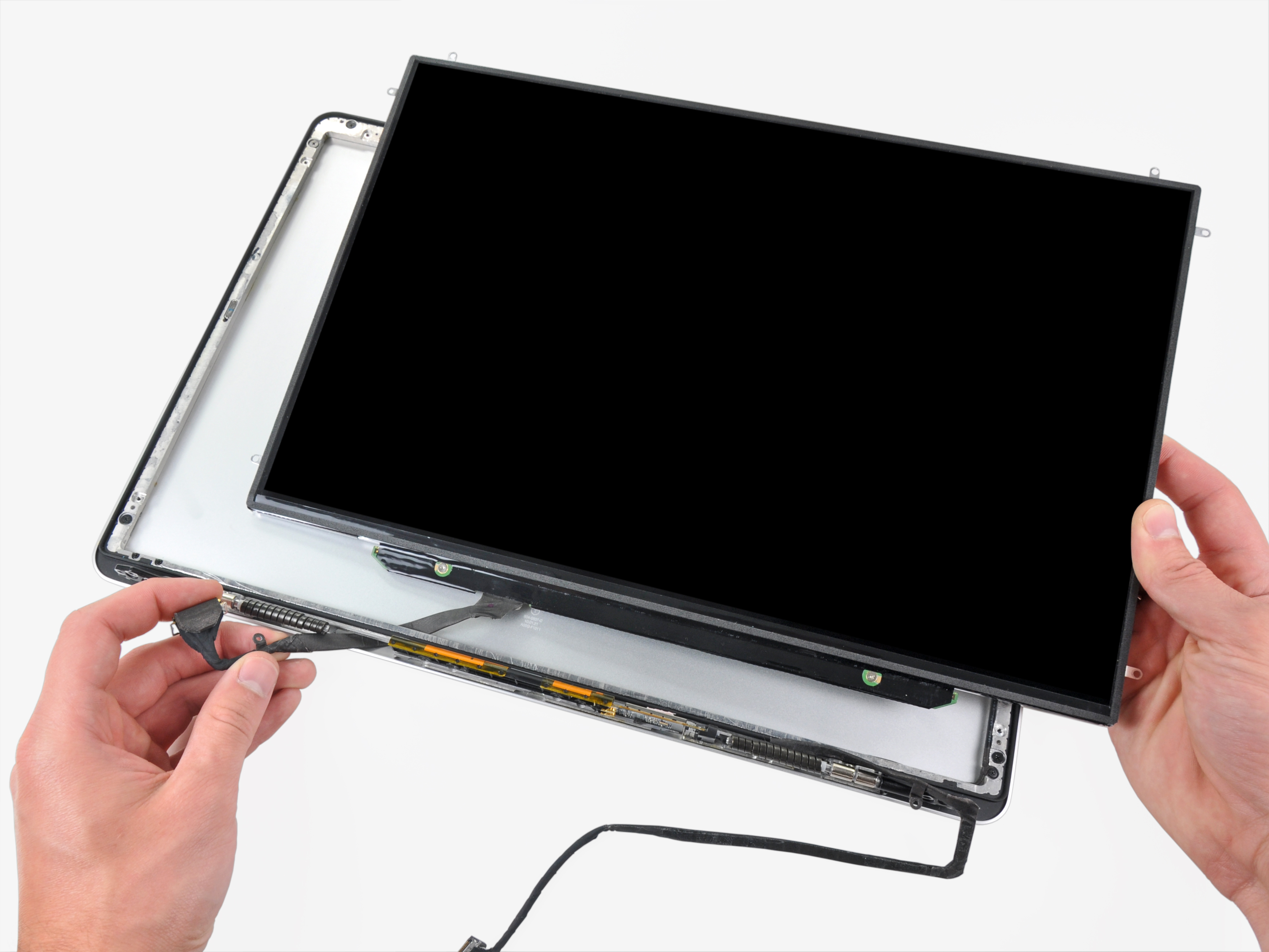

  26. MacBook Pro 15" Unibody Late 2008 and Early 2009 LCD Replacement: step 26, image 1 of 1
    • Remove the six 2.9 mm Phillips screws securing the LCD panel to the front bezel.
  27. MacBook Pro 15" Unibody Late 2008 and Early 2009 LCD Replacement: step 27, image 1 of 1
    • Pull the LCD toward the top edge of the display to slide the circuitry along its lower edge out of the recess in the aluminum display assembly.
    • It may be helpful to use one hand to feed the display data cable through its channel in the aluminum display assembly as you pull the LCD toward the top edge of the display with the other hand.
  28. MacBook Pro 15" Unibody Late 2008 and Early 2009 LCD Replacement: step 28, image 1 of 1
    • Peel the piece of tape covering the display data cable connector away from the edge closest to the LCD.
  29. MacBook Pro 15" Unibody Late 2008 and Early 2009 LCD Replacement: step 29, image 1 of 2 MacBook Pro 15" Unibody Late 2008 and Early 2009 LCD Replacement: step 29, image 2 of 2
    • Use the tip of a spudger to flip up the thin steel retaining clip securing the display data cable to its socket on the LCD.
    • Pull the display data cable straight away from its socket on the LCD.
    • Lift the LCD out of the display assembly and set it aside.
    • If you are replacing the LVDS/display data cable, simply de-route it from its slot cut into the display casing.
