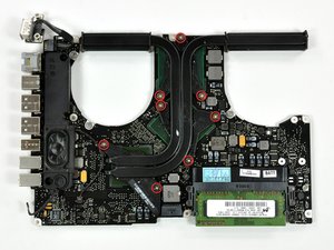

The heat sink helps keep the processor cool and happy.
Image #1 Image #2
