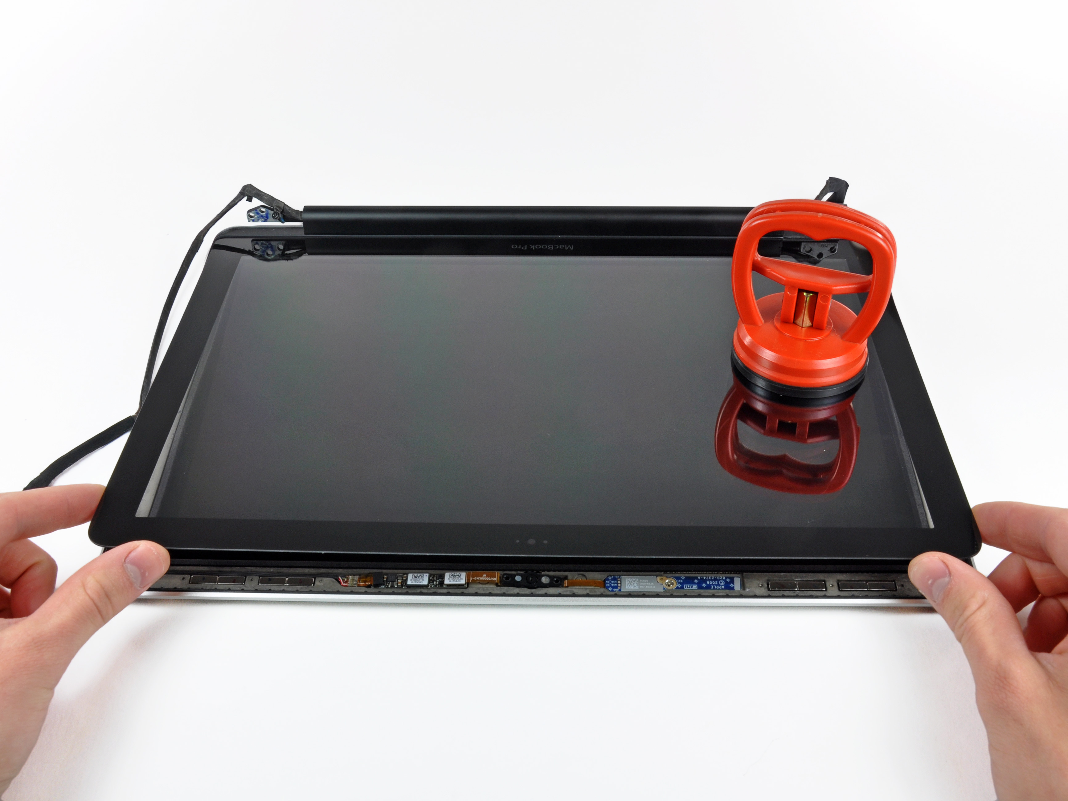

Use this guide to replace a broken front display glass panel. Removal of the front display glass is required to access the LCD. Although it is not technically necessary to remove the display to access the front display glass, it greatly simplifies the task. This guide is not applicable for anti-glare displays.

Add Note Edit Step 6 — Display Assembly  ¶
  • If necessary, peel the EMI gasket off the camera cable connector.
  • Disconnect the camera cable by pulling the male end straight away from its socket toward the optical drive opening.
  • Do not try to lift this connector straight up off the board. Pull the connector parallel to the face of the logic board.
  • Deroute the camera data cable from the channel in the optical drive.
Image #1 Image #2
Add Note Edit Step 7  ¶
  • Remove the two Phillips screws securing the camera cable bracket to the upper case.
  • The leftmost screw may remain captive in the camera cable.
  • Seperate the camera cable bracket from the camera cable and remove it from the computer.
Image #1 Image #2
Add Note Edit Step 8  ¶
  • Grab the plastic pull tab secured to the LVDS cable lock and rotate it toward the DC-in side of the computer.
  • Pull the LVDS connector straight away from its socket.
  • When disconnecting the LVDS cable, do not pull on the black tab secured to the LVDS cable lock. We recommend wiggling the cable while applying tension to slowly "walk" the connector out of its socket.
