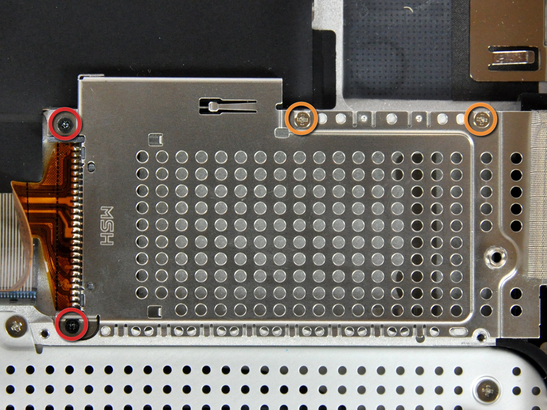

This guide will show you how to replace the ExpressCard cage.
Sections
Image #1 Image #2
Add Note Edit Step 1 — Access Door  ¶
  • With the case closed, place the Unibody top-side down on a flat surface.
  • Depress the grooved side of the access door release latch enough to grab the free end. Lift the release latch until it is vertical.
Image #1
Add Note Edit Step 2  ¶
  • The access door should now be raised enough to lift it up and out of the Unibody.
Image #1
  • Be sure the access door release latch is vertical before proceeding.
  • Grab the translucent plastic tab and pull the battery up and out of the Unibody.
  • If the latch is depressed it will lock the battery in place.
Image #1
Add Note Edit Step 4 — Lower Case  ¶
  • Remove the following eight screws securing the lower case to the chassis:
    • One 5.4 mm Phillips screw.
    • Three 14 mm Phillips screws.
    • Four 3.5 mm Phillips screws.
Image #1
Add Note Edit Step 5  ¶
  • Using both hands, lift and remove the lower case off the upper case.
Image #1
Add Note Edit Step 6 — Mid Wall  ¶
  • Remove the following 5 screws securing the mid wall to the upper case:
    • Three 10.5 mm Phillips screws.
    • Two 3.7 mm Phillips screws.
Image #1
Add Note Edit Step 7  ¶
  • Lift the mid wall out of the upper case.
Image #1 Image #2 Image #3
Add Note Edit Step 8 — Logic Board  ¶
  • Remove the following six screws securing both the right fan and the left fan to the logic board:
    • Two 3.2 mm Phillips screws.
  • Use a spudger to pry both the right fan and left fan connectors straight up and out of their sockets on the logic board.
  • It is useful to twist the spudger axially from beneath the fan cable wires to release the connector.
  • The fan socket and the fan connector can be seen in the second and third pictures. Be careful not to break the plastic fan socket off the logic board as you use your spudger to lift the fan connector straight up and out of its socket. The layout of the logic board shown in the second picture may look slightly different than your machine but the fan socket is the same.
