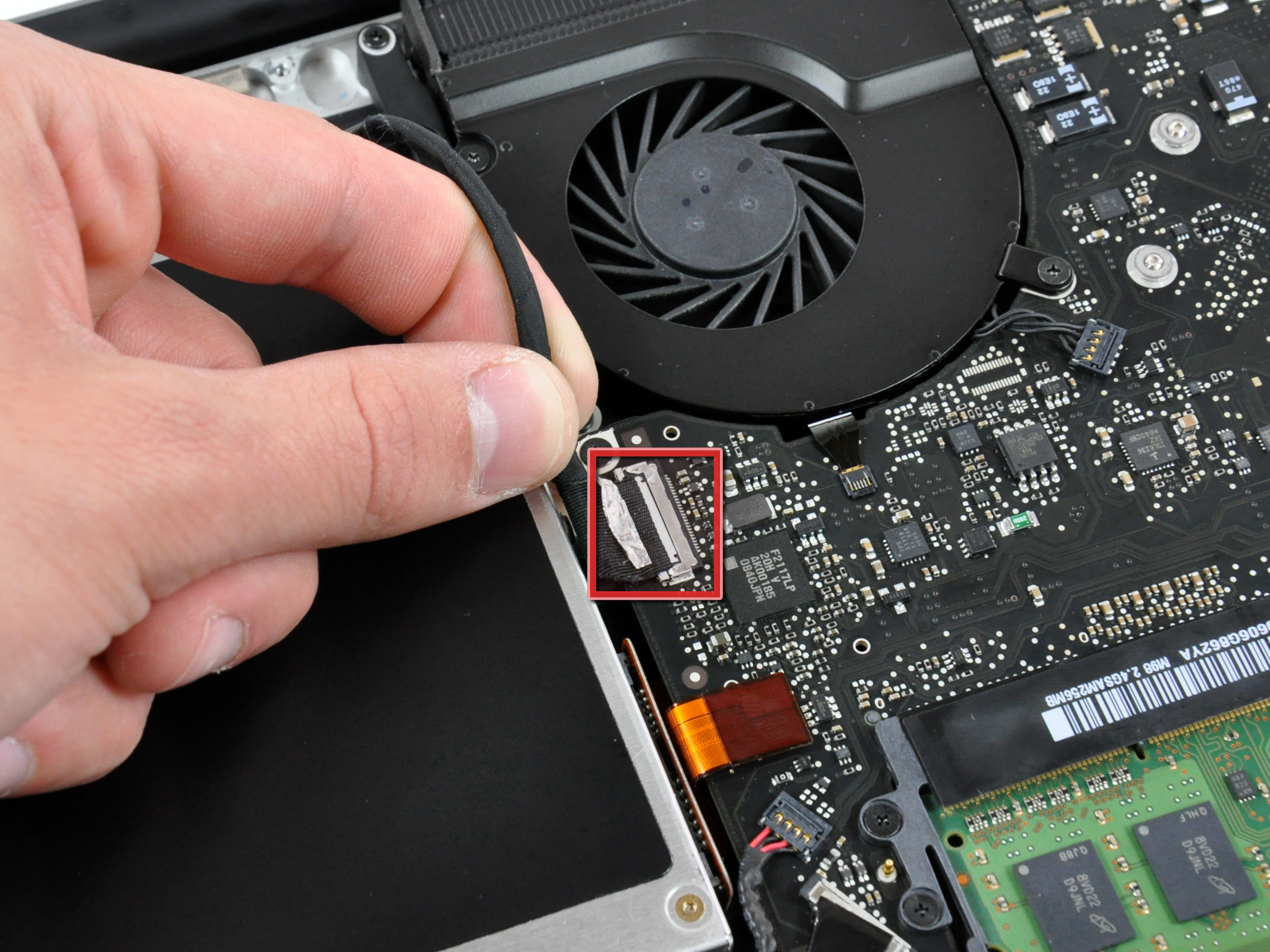

Add Note Edit Step 6 — Display Assembly  ¶
  • If necessary, peel the EMI gasket off the camera cable connector.
  • Disconnect the camera cable by pulling the male end straight away from its socket toward the optical drive opening.
  • Do not try to lift this connector straight up off the board. Pull the connector parallel to the face of the logic board.
  • Deroute the camera data cable from the channel in the optical drive.
