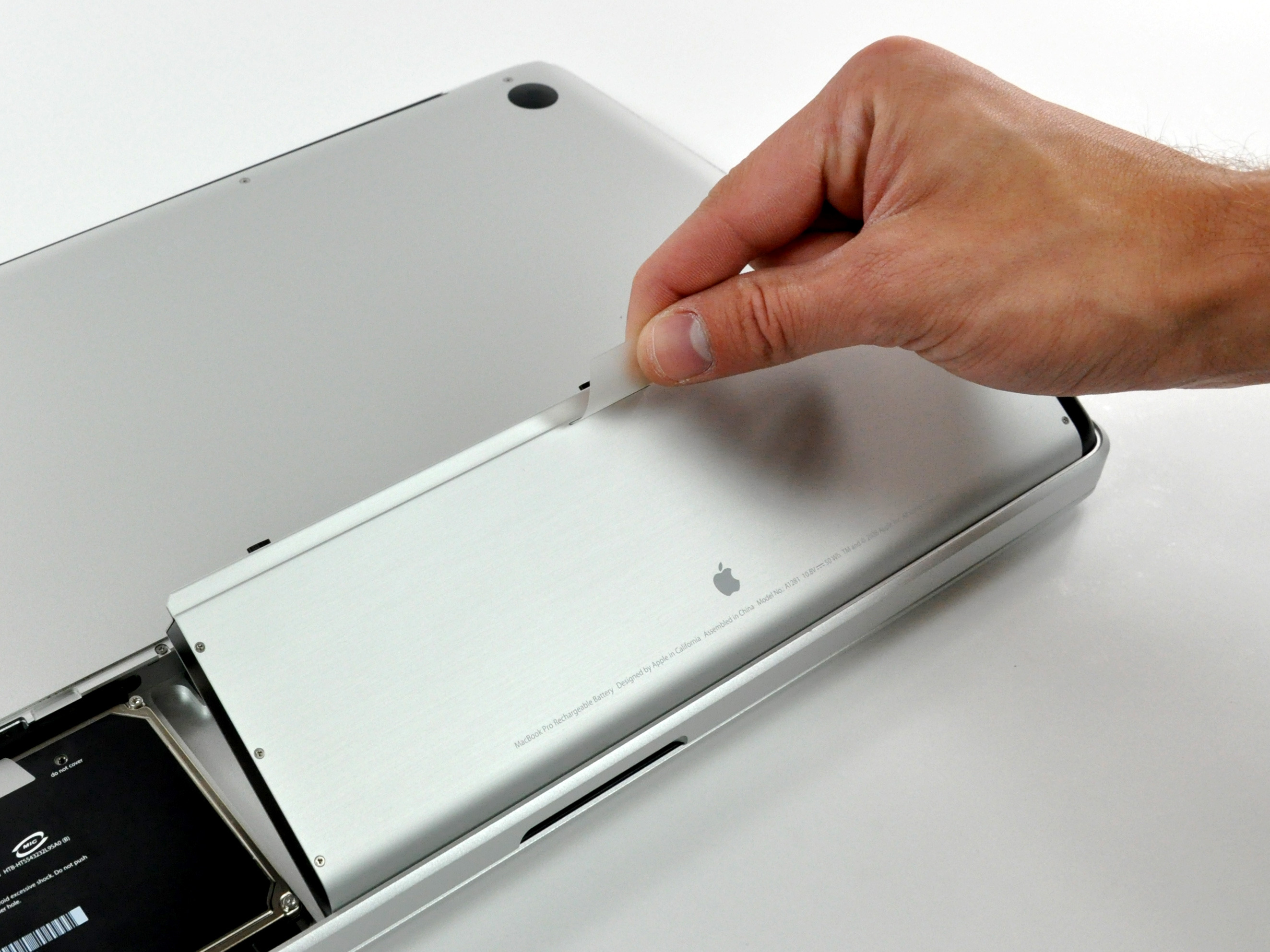

    • With the case closed, place the Unibody top-side down on a flat surface.
    • Depress the grooved side of the access door release latch enough to grab the free end. Lift the release latch until it is vertical.
  2. MacBook Pro 15" Unibody Late 2008 and Early 2009 Battery Replacement: step 2, image 1 of 1
    • The access door should now be raised enough to lift it up and out of the Unibody.
  3. MacBook Pro 15" Unibody Late 2008 and Early 2009 Battery Replacement, Battery: step 3, image 1 of 1
    • Be sure the access door release latch is vertical before proceeding.
    • Grab the translucent plastic tab and pull the battery up and out of the Unibody.
    • If the latch is depressed it will lock the battery in place.
