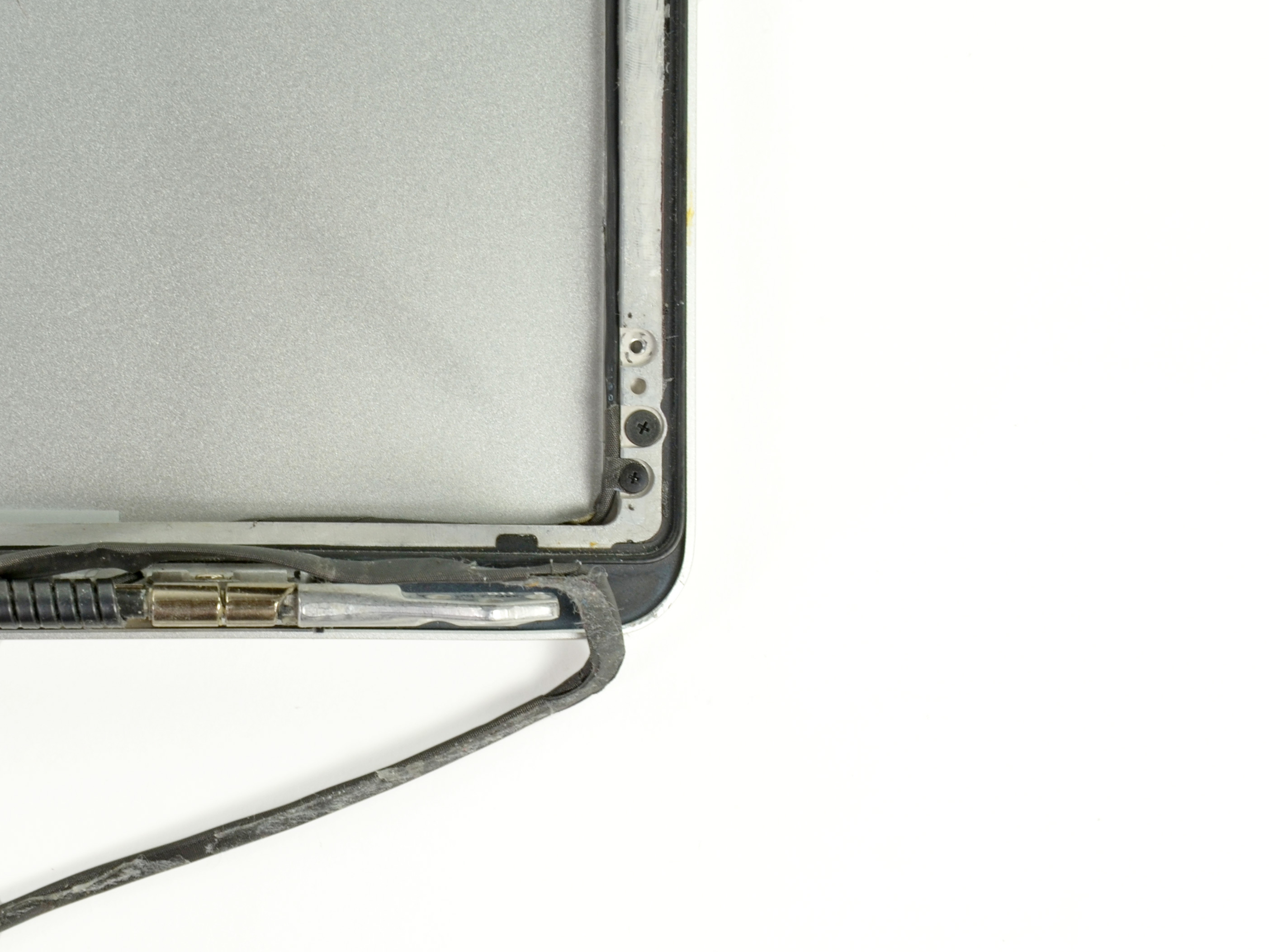

Image #1
Add Note Edit Step 37  ¶
  • Pull the AirPort/iSight cable through the opening located near the bottom right corner of the display assembly.
  • Remove the AirPort/iSight cable from the display assembly.
