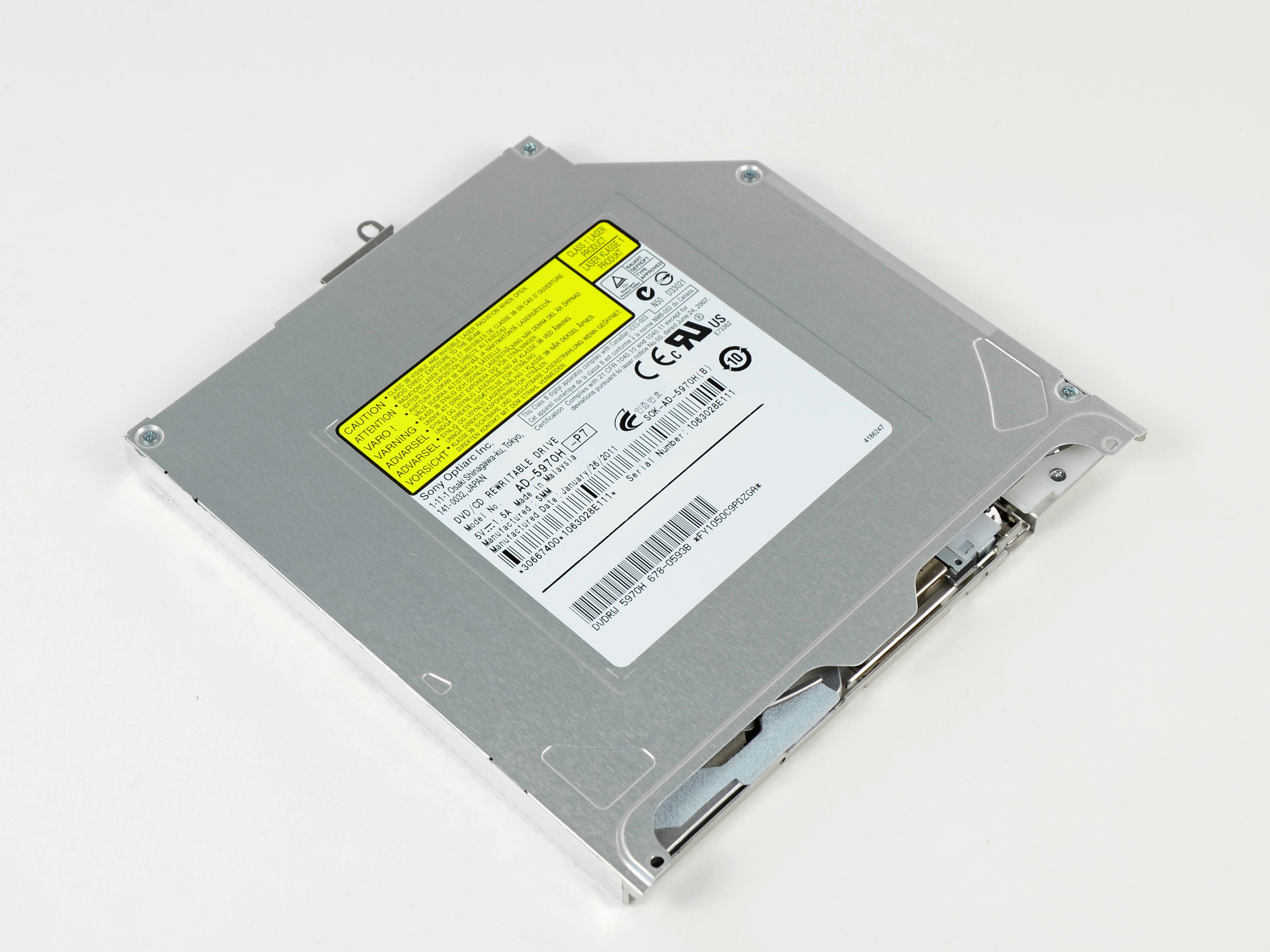

    • Remove the three 3.5 mm T6 Torx screws securing the optical drive to the upper case.
  10. MacBook Pro 15" Unibody Early 2011 Optical Drive Replacement: step 10, image 1 of 1
    • Lift the optical drive near its connector and pull it away from the upper case to remove it from the computer.
  11. MacBook Pro 15" Unibody Early 2011 Optical Drive Replacement, Optical Drive Cable: step 11, image 1 of 2 MacBook Pro 15" Unibody Early 2011 Optical Drive Replacement, Optical Drive Cable: step 11, image 2 of 2
    • Pull the optical drive cable out of the optical drive.
    • Be sure to pull by the edges of the connector, not by the cable itself.
    • Remove the two black Phillips #0 screws securing the small metal mounting bracket. Transfer this bracket to your new optical drive or hard drive enclosure.
  12. MacBook Pro 15" Unibody Early 2011 Optical Drive Replacement, Optical Drive: step 12, image 1 of 1
    • Optical drive remains.
