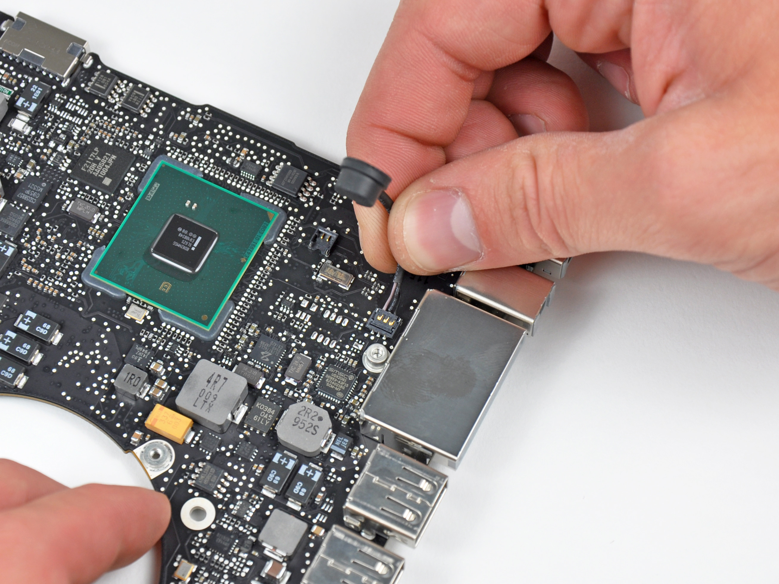

Installing MacBook Pro 15" Unibody Early 2011 Microphone
Restore recording capability by replacing the microphone on your Early 2011 MacBook Pro 15" Unibody.
Replacing the microphone requires removal of the logic board.
Image #1
    • Three 13.5 mm (14.1 mm) Phillips screws.
    • Seven 3 mm Phillips screws.
Image #1
Add Note Edit Step 2  ¶
  • Using both hands, lift the lower case near the vent to pop it off two clips securing it to the upper case.
Image #1 Image #2
Add Note Edit Step 3 — Battery Connector  ¶
  • For certain repairs (e.g. hard drive), disconnecting the battery connector is not necessary but it prevents any accidental shorting of electronics on the motherboard. If you do not disconnect the battery connector, please be careful as parts of the motherboard might be electrified.
  • Use the edge of a spudger to pry the battery connector upwards from its socket on the logic board.
  • It is useful to pry upward on both short sides of the connector to "walk" it out of its socket.
Image #1
Add Note Edit Step 4  ¶
  • Bend the battery cable slightly away from its socket on the logic board so it does not accidentally connect itself while you work.
Image #1
Add Note Edit Step 5 — Left Fan  ¶
  • Remove the three 3.4 mm (3.1 mm) T6 Torx screws securing the left fan to the logic board.
Image #1 Image #2 Image #3
Add Note Edit Step 6  ¶
  • Use the flat end of a spudger to disconnect the left fan connector from the logic board.
  • It is useful to twist the spudger axially from beneath the fan cable wires to release the connector.
  • The fan socket and the fan connector can be seen in the second and third pictures. Be careful not to break the plastic fan socket off the logic board as you use your spudger to lift the fan connector straight up and out of its socket. The layout of the logic board shown in the second picture may look slightly different than your machine but the fan socket is the same.
Image #1
Add Note Edit Step 7  ¶
  • Lift the left fan out of the upper case.
Image #1
Add Note Edit Step 8 — Logic Board  ¶
  • Use the flat end of a spudger to lift the right fan connector out of its socket on the logic board.
