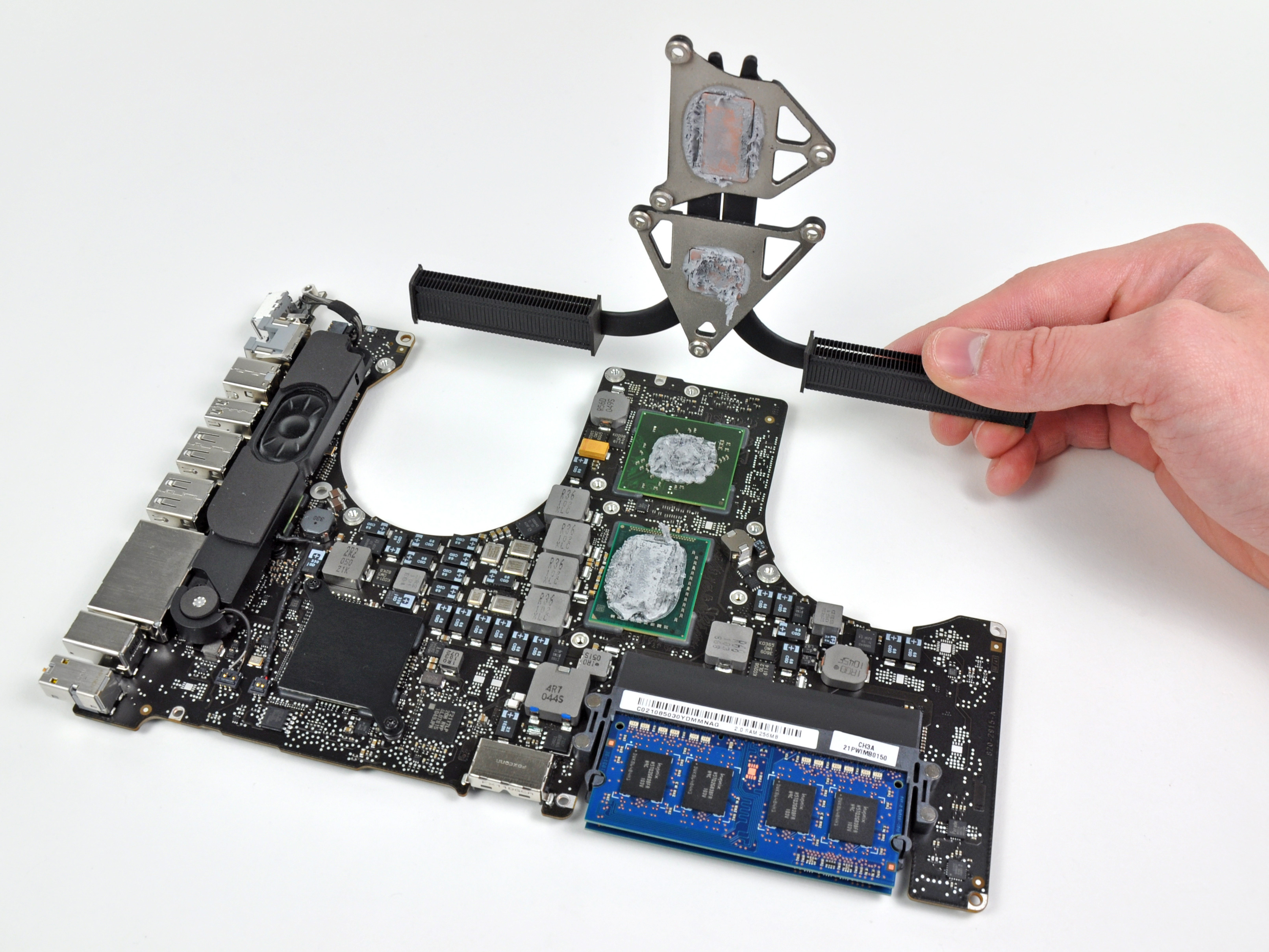

  23. MacBook Pro 15" Unibody Early 2011 Heat Sink Replacement, Heat Sink: step 23, image 1 of 1
    • Lay the logic board down on a soft flat surface with the heat sink facing up.
    • Remove the six #1 Phillips screws securing the heat sink to the logic board.
    • Keep track of the small springs housed under each screw.
  24. MacBook Pro 15" Unibody Early 2011 Heat Sink Replacement: step 24, image 1 of 1
    • Remove the heat sink from the logic board.
    • If the heat sink appears to be stuck to the logic board after removing all six screws, it may be helpful to use a spudger to separate the two components.
    • If you need to mount the heat sink back onto the logic board, we have a thermal paste guide that makes replacing the thermal compound easy.

Has anyone replaced the paste on the 2 smaller square heat sinks that are over the IO controller and thunderbolt chips?
Sarah Ybarra - Reply
In case anyone is wondering, you can find k5-pro on Amazon if you need to replace the thick gunk on the other 2 big chips (IO controller and thunderbolt I think). Didn't realize until I was putting the plates back on that there is quite a gap between the chip and the heat sink. Took me days of asking on forums to find out about the K5 stuff. :D
Sarah Ybarra -
I removed and super clean on my MacBook Pro 15" Unibody Early 2011 I use Arctic MX-4 on both side. Test running with my Apple 27 inch screen it shut down again overheat even both fans are running, I removed bottom cover and small support to let cool air. Start again same problems I disconnect cable thunderbolt from 27” screen bottom not cover now no problem running on 15 “ screen but still felt it less heat then was too hot. Do you think that Heat Sink need Replacement could be the problem ?
Thanks, John
John Hungerford - Reply
@alpinejwh The heat sink has no moving parts and usually won’t need servicing/replacement as long as the vents are clean and clear of obstruction. If anything, my guess would be an error in the procedure. I’d probably go back and re-check everything and reapply the thermal paste. Make sure you’re following the application instructions for your particular processor type. Make sure the heat sink screws are correctly tightened and none of the springs are missing. Good luck!
Jeff Suovanen -
This procedure totally worked for me. I did not replace the heat sink just the paste. The machine works well but I realize this problem could crop up again from what I am reading about these particular MacBooks. Thanks Walter!
