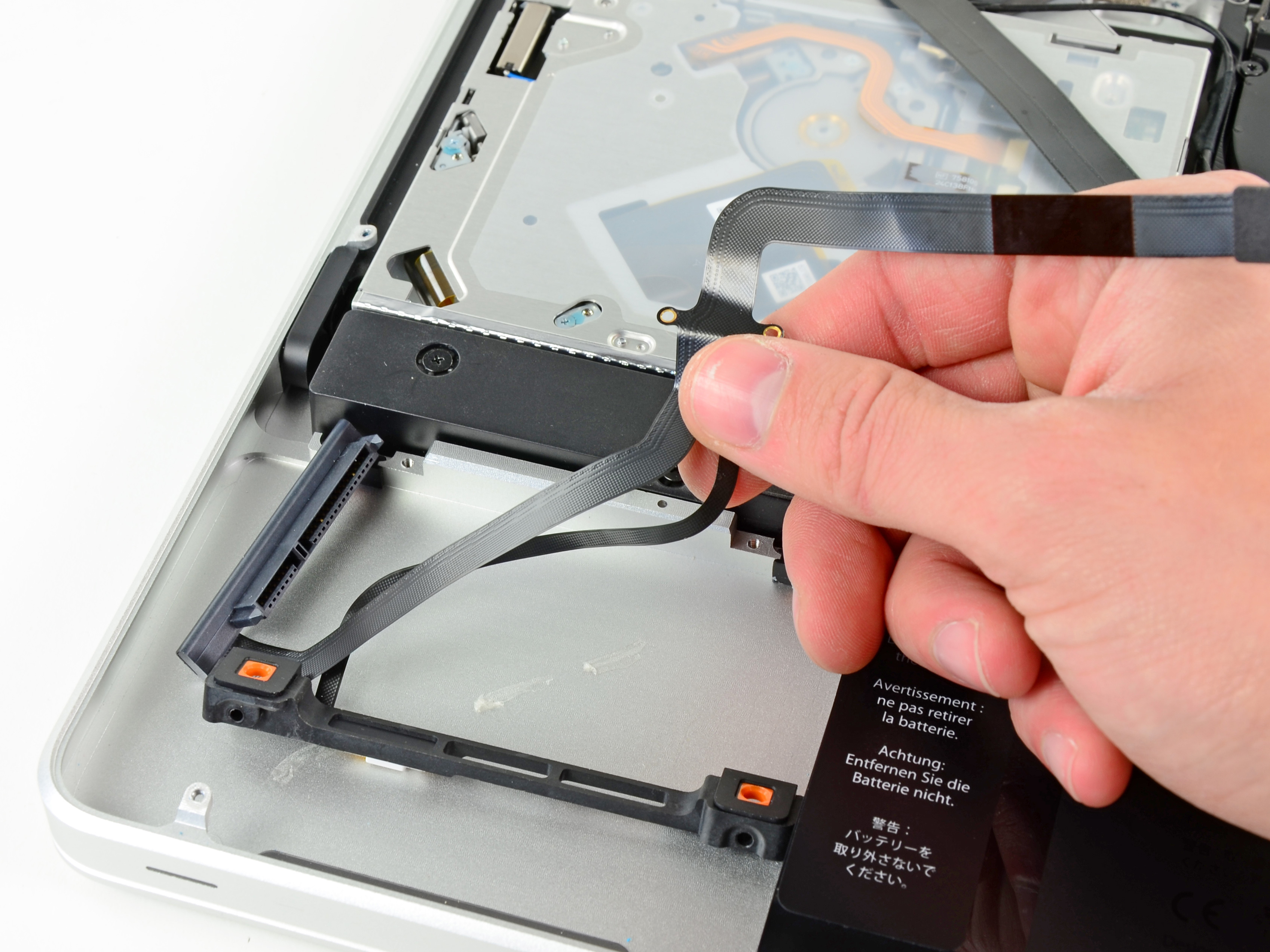

Add Note Edit Step 7  ¶
  • Lift the hard drive by its pull tab and pull it out of the chassis, minding the cable attaching it to the computer.
Image #1 Image #2
Add Note Edit Step 8  ¶
  • Remove the hard drive cable by pulling its connector straight away from the hard drive.
