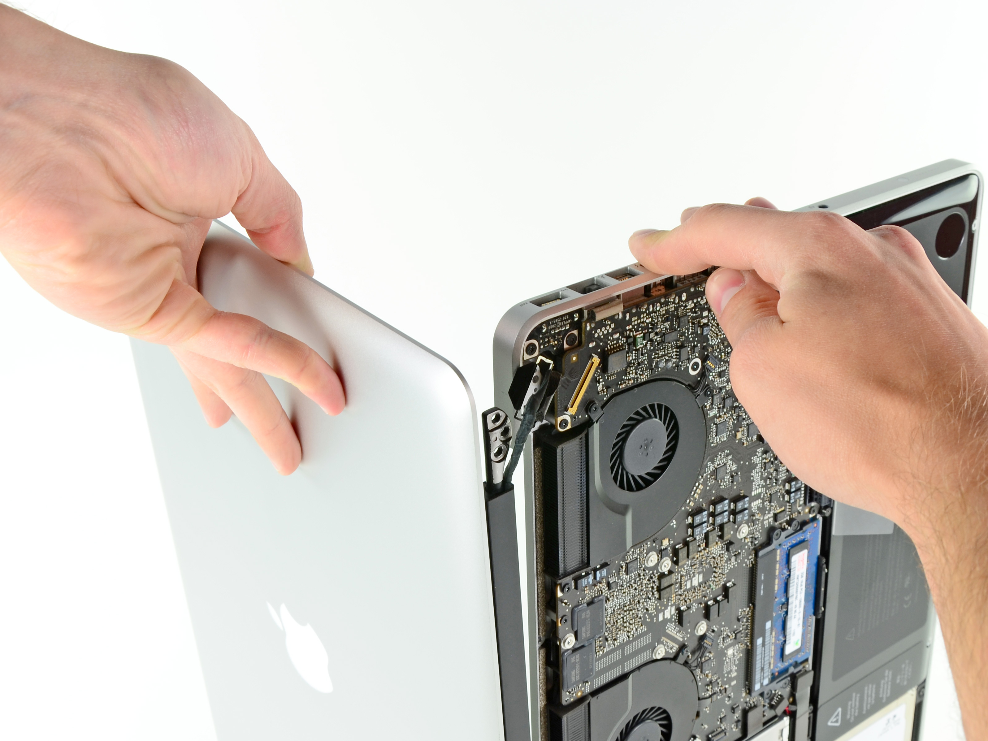

  16. MacBook Pro 15" Unibody Early 2011 Display Replacement: step 16, image 1 of 1
    • Open your MacBook Pro so the display is perpendicular to the upper case.
    • Place your opened MacBook Pro on a table as pictured.
    • While holding the display and upper case together with your left hand, remove the remaining T6 Torx screw from the upper display bracket.
  17. MacBook Pro 15" Unibody Early 2011 Display Replacement: step 17, image 1 of 1
    • Be sure to hold the display and upper case together with your left hand. Failure to do so may cause the freed display/upper case to fall, potentially damaging each component.
    • Remove the last remaining T6 Torx screw securing the display to the upper case.
  18. MacBook Pro 15" Unibody Early 2011 Display Replacement: step 18, image 1 of 3 MacBook Pro 15" Unibody Early 2011 Display Replacement: step 18, image 2 of 3 MacBook Pro 15" Unibody Early 2011 Display Replacement: step 18, image 3 of 3
    • Grab the upper case with your right hand and rotate it slightly toward the top of the display so the upper display bracket clears the edge of the upper case.
    • Rotate the display slightly away from the upper case.
    • Lift the display up and away from the upper case, minding any brackets or cables that may get caught.
