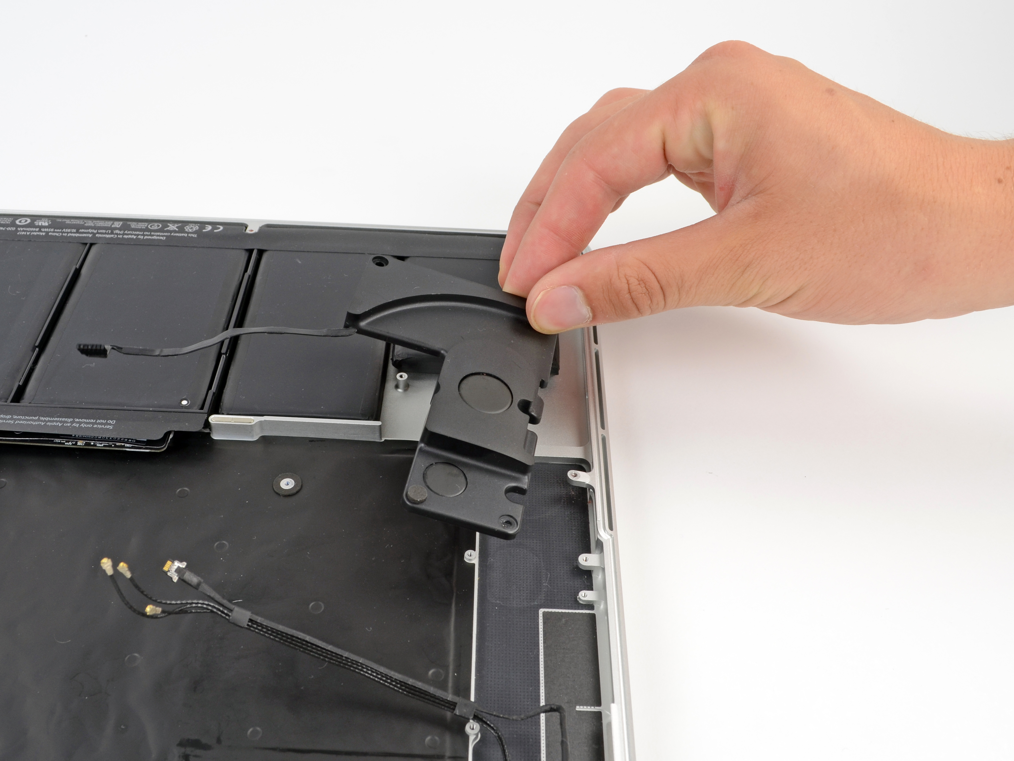

The left and right speakers are paired together in the MacBook Pro with Retina display. Therefore, they should be replaced as a pair. Use this guide to help you out with that process.
Image #1
  • Remove the following pentalobe screws securing the lower case to the MacBook Pro with Retina display.
    • Eight 3.0 mm
    • Two 2.3 mm
Image #1
Add Note Edit Step 2  ¶
  • Lifting from the edge nearest the clutch cover, lift the lower case off the MacBook Pro.
  • Set the lower case aside.
Image #1
Add Note Edit Step 3 — Battery Connector  ¶
  • Peel back the warning label covering the battery connector.
Image #1 Image #2
Add Note Edit Step 4  ¶
  • Using the flat end of a spudger, gently pry the battery connector straight up out of its socket on the logic board.
  • Bend the battery cables back and out of the way, ensuring that the battery connector doesn't accidentally make contact with the logic board.
Image #1
Add Note Edit Step 5 — AirPort/Camera Cable  ¶
  • Use the tip of a spudger to pry the three AirPort antenna cables straight up off of their sockets on the AirPort board.
Image #1
Add Note Edit Step 6  ¶
  • Use the tip of a spudger to push the camera cable connector out of its socket on the logic board.
    • Be sure to push parallel to the board, pushing first on one side, then the other to "walk" the connector out of its socket.
Image #1 Image #2 Image #3
Add Note Edit Step 7  ¶
  • Insert the flat end of a spudger underneath the rubber heat sink cover on the right fan.
  • Slide the spudger underneath the length of the cover, releasing the adhesive.
  • Lift the cover and flip it back so that you can access the cables underneath.
Add Note Edit Step 8  ¶
  • Use your fingers to pull the AirPort/Camera cables up off the fan.
    • The cables are adhered to the fan, so peel them up carefully to prevent ripping any.
  • Carefully de-route the cables from the plastic cable guide.
