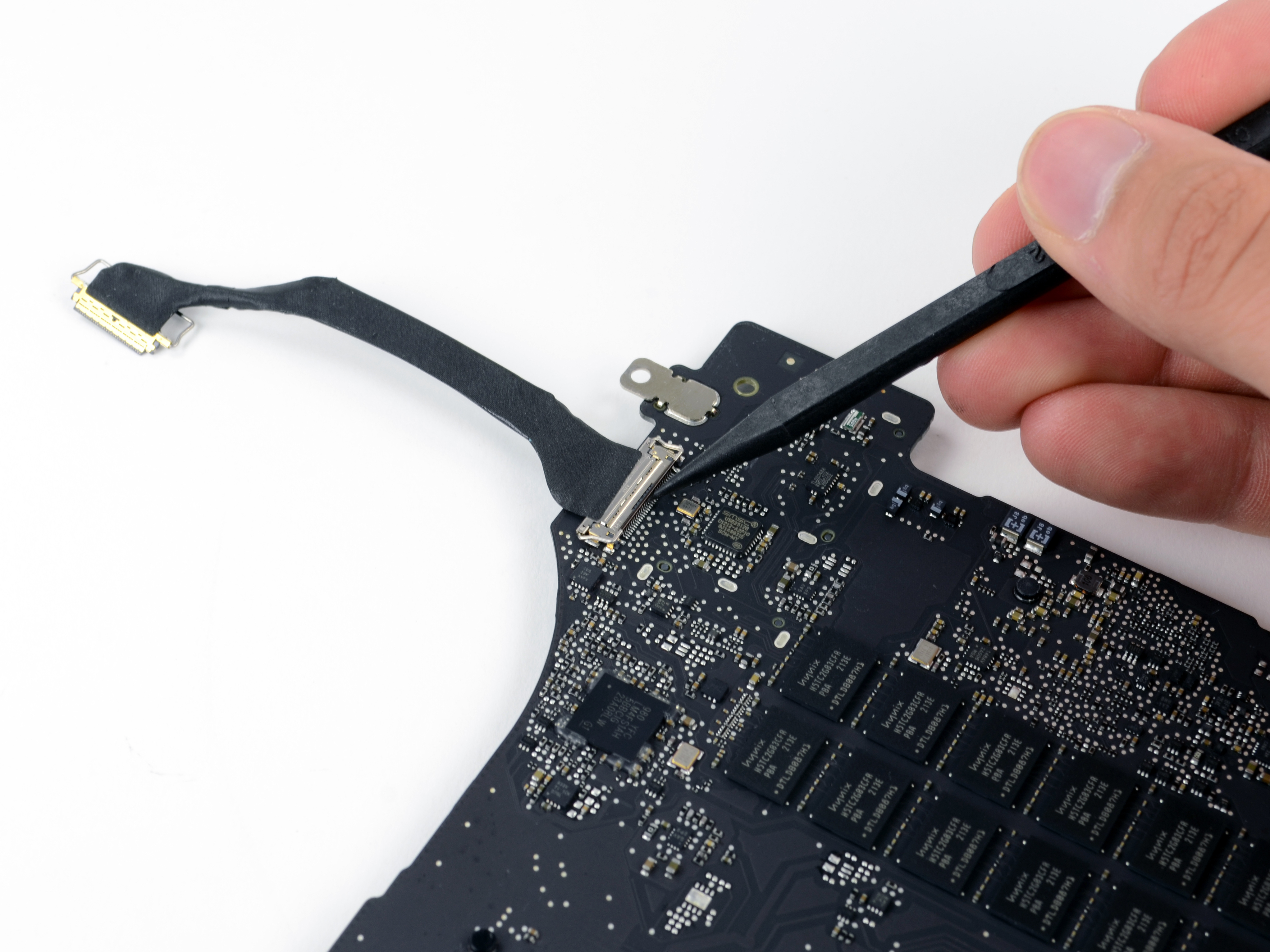

Add Note Edit Step 6  ¶
  • Use the tip of a spudger to push the camera cable connector out of its socket on the logic board.
    • Be sure to push parallel to the board, pushing first on one side, then the other to "walk" the connector out of its socket.
Image #1 Image #2 Image #3
