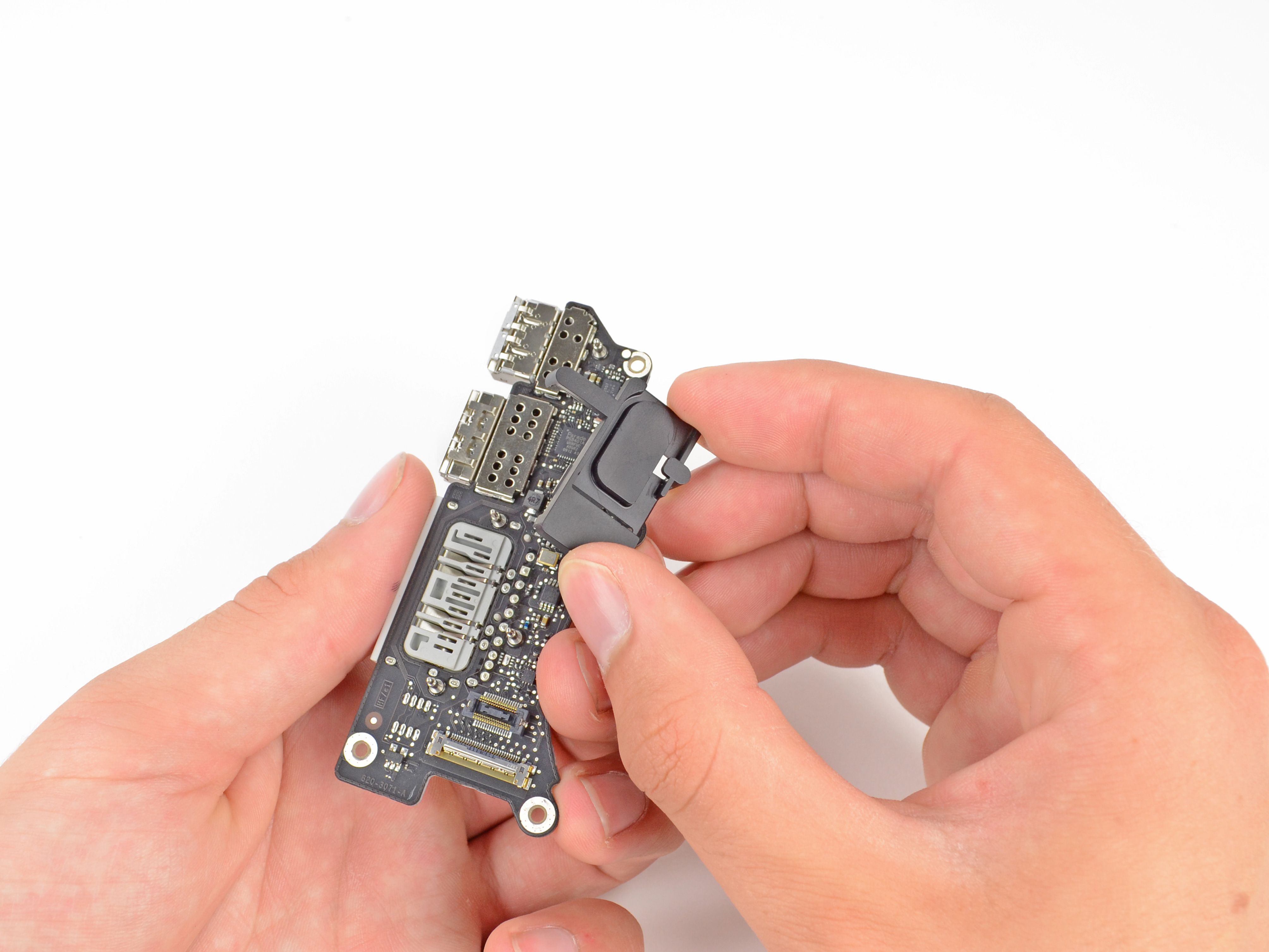

Installing MacBook Pro 15" Retina Display Mid 2012 I/O Board
Replace the I/O board on the MacBook Pro 15" Retina Display Mid 2012.
Use this guide to install an I/O board containing a USB 3.0 port, HDMI port, and SDXC card reader.
