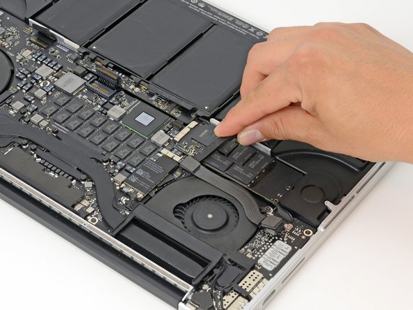

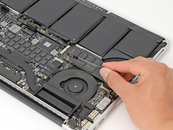

Add Note Edit Step 3 — Battery Connector  ¶
  • Peel back the warning label covering the battery connector.
Image #1 Image #2
Add Note Edit Step 4  ¶
  • Using the flat end of a spudger, gently pry the battery connector straight up out of its socket on the logic board.
  • Bend the battery cables back and out of the way, ensuring that the battery connector doesn't accidentally make contact with the logic board.

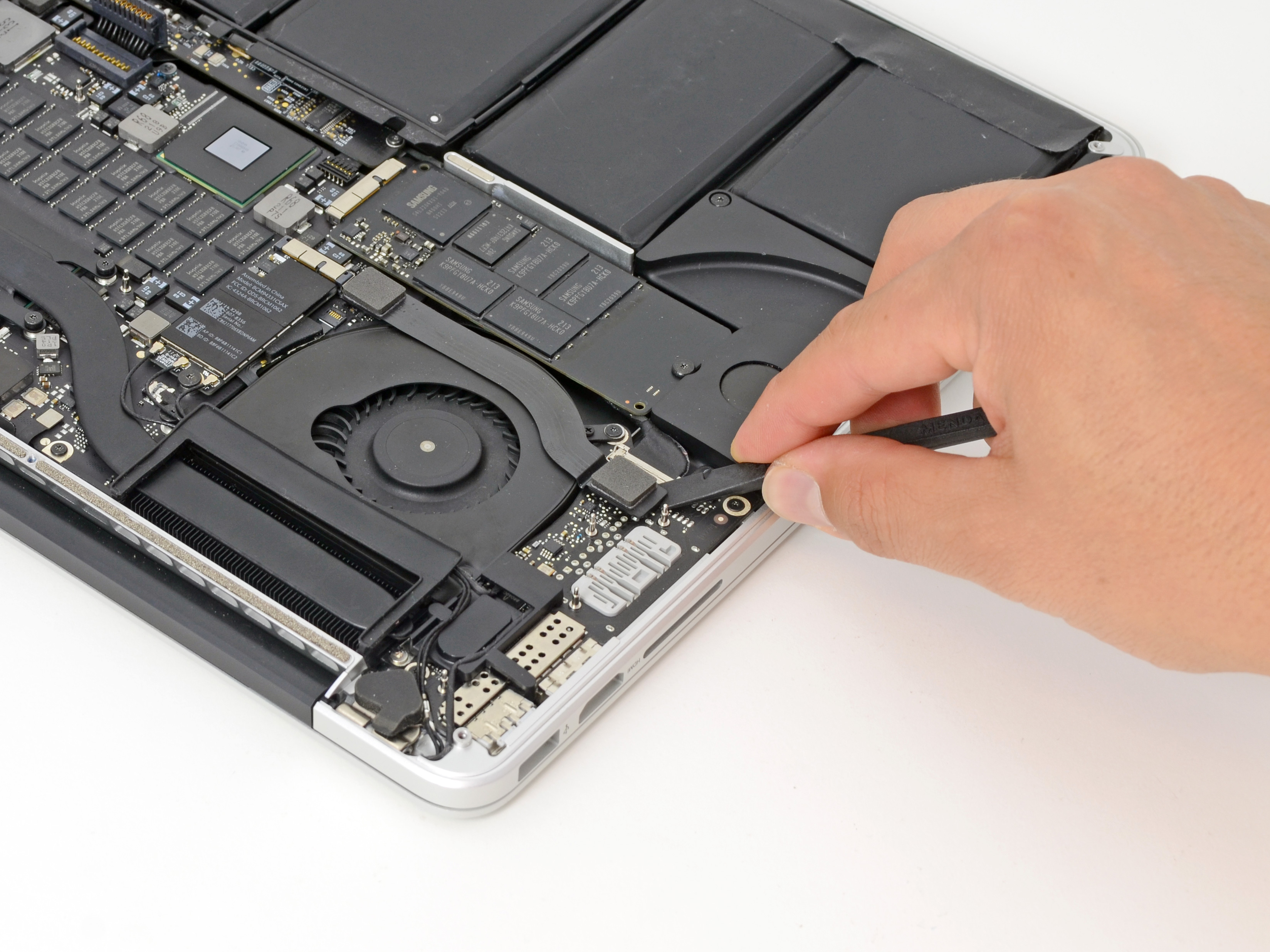

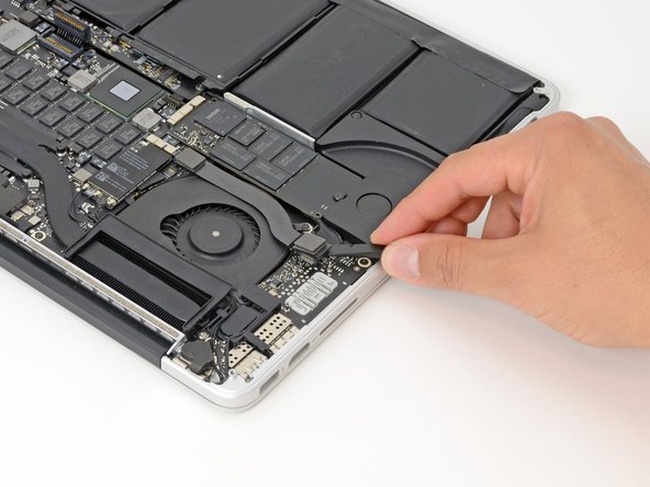

Add Note Edit Step 5 — I/O Board Cable  ¶
  • Using the flat end of a spudger, pry the I/O board cable straight up out of its socket on the I/O board.
  • In a similar fashion, remove the I/O board cable from its socket on the I/O board.
Image #1
Add Note Edit Step 6  ¶
  • Remove the I/O board cable from the MacBook Pro.
