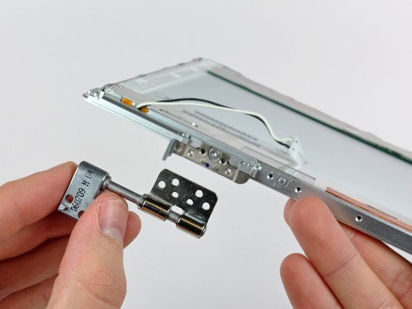

De-route the display data cable from around the right clutch hinge and remove it from the front bezel.

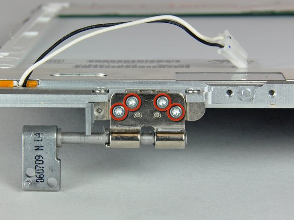

Remove the four T6 Torx screws securing the right clutch hinge to the front display bezel.
Remove the right clutch hinge from the front display bezel.
