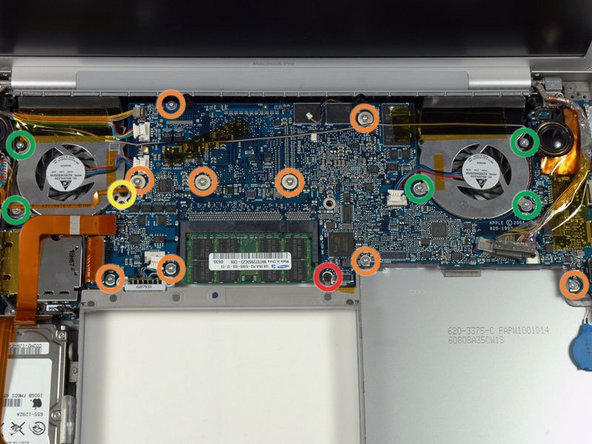

  • Remove the following 16 screws, moving cables as necessary:
    • One 4.4 mm black Phillips screw to the right of the RAM slot.
    • Nine 4.7 mm silver T6 Torx screws securing the logic board to the lower case.
    • One 6.2 mm black T6 Torx screw on the right side of the left fan.
    • Five 9.4 mm silver T6 Torx screws securing the left and right fans.

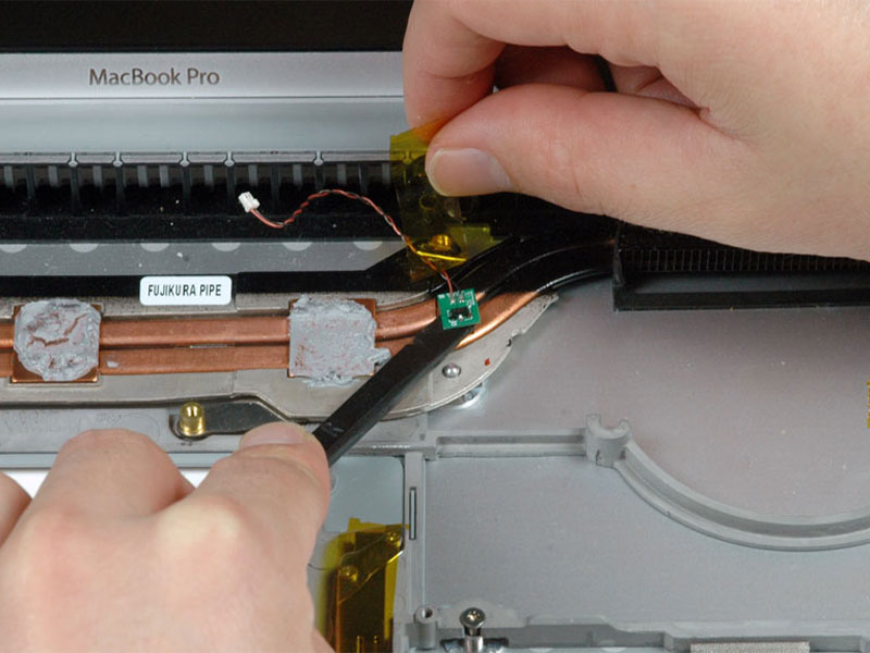

Add Note Edit Step 29 — Left Thermal Sensor  ¶
  • Peel back the orange Kapton tape covering the left thermal sensor.
  • Use a spudger to pry the left thermal sensor off the heat sink.
