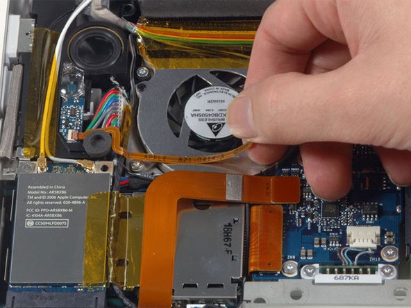

Add Note Edit Step 11 — Left Ambient Light Sensor  ¶
  • Use a spudger to flip up the brown plastic flap securing the left ambient light sensor cable to the logic board.
  • Slide the left ambient light sensor cable to the left and out of its connector.

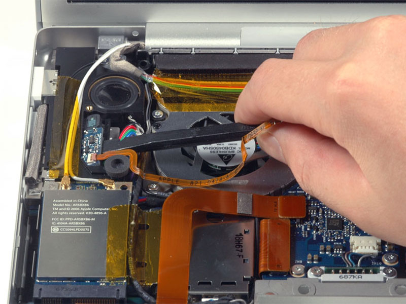

Add Note Edit Step 12  ¶
  • Peel up the left ambient light sensor cable from above the left fan.

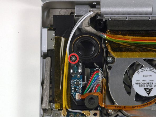

Add Note Edit Step 13  ¶
  • Remove the single silver Phillips screw securing the clear plastic shield over the left ambient light sensor.
  • Lift the clear plastic shield off the left ambient light sensor.

Add Note Edit Step 14  ¶
  • Use a spudger to pry the left ambient light sensor board out of its housing on the left speaker.
  • Lift the left ambient light sensor board out of the computer.
