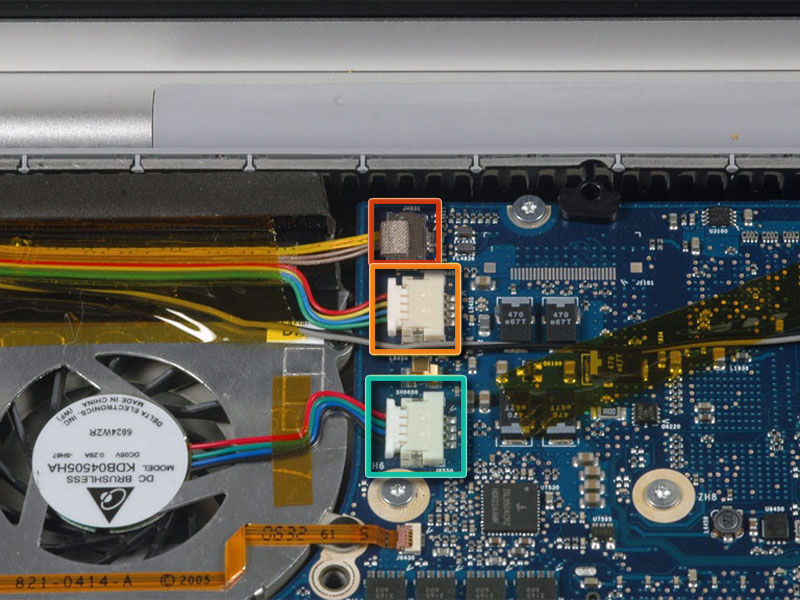

  • Reconnect the following connectors back in their respective sockets on the logic board:
    • Camera connector cable
    • Inverter cable
    • Left fan
    • Display data cable
  • Do not reassemble the display to the lower case assembly just yet. The display can lay next to the laptop.
