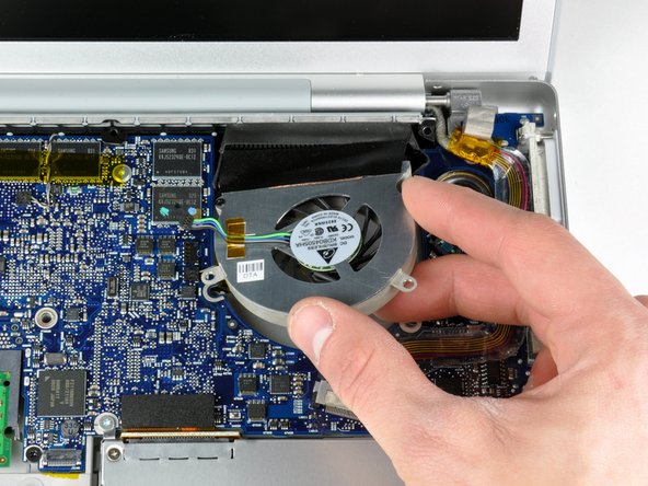

Add Note Edit Step 10 — Right Fan  ¶
  • Disconnect the right fan cable from the logic board by placing a spudger beneath the cable and lifting up.
Image #1 Image #2
Add Note Edit Step 11  ¶
  • Remove the three silver T6 Torx screws securing the right fan to the logic board and lower case.
  • Lift the right fan up and carefully peel up the tape securing the fan to the heat sink as you go.
Image #1 Image #2

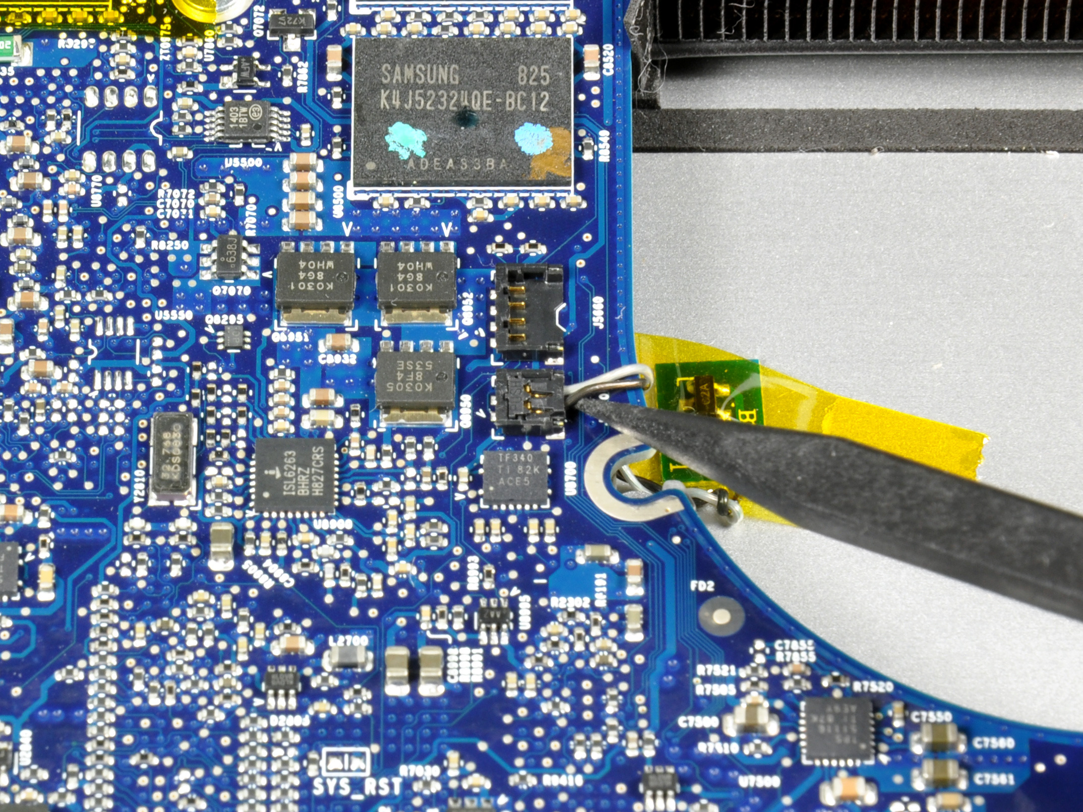

Add Note Edit Step 12 — Right Thermal Sensor  ¶
  • Use caution when removing the thermal sensor connector. The connector can easily break off the logic board if this step is performed improperly.
  • Disconnect the right thermal sensor cable from the logic board by placing a spudger beneath the cable and lifting up.
  • Peel up the orange Kapton tape covering the right thermal sensor.
  • Use a spudger to pry the right thermal sensor off the lower case.
