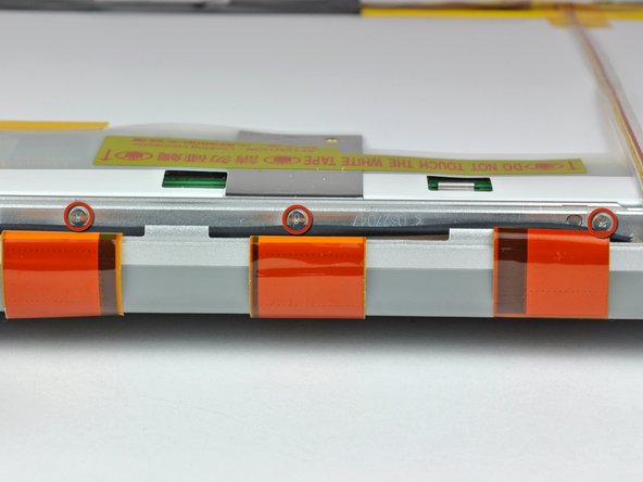

Add Note Edit Step 33  ¶
  • Remove the three Phillips screws behind antenna straps along the bottom edge of the display.

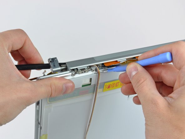

Add Note Edit Step 34  ¶

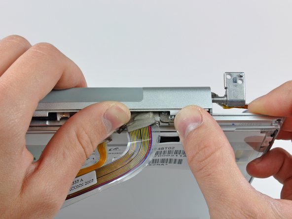

  • To remove the clutch assembly, first insert the flat end of a spudger into the gap between the clutch hinge and the clutch cover where the cables exit.
  • While prying the clutch assembly away from the clutch hinge with your spudger, use a plastic opening tool to increase the gap between the clutch cover and the front display bezel.
  • Work your way along the length of the clutch cover to fully separate the adhesive.

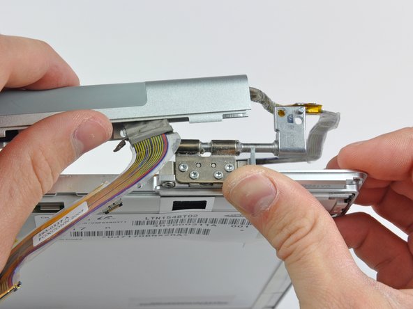

Add Note Edit Step 35  ¶
  • Push the clutch assembly off each of the clutch hinges and remove it from the display.

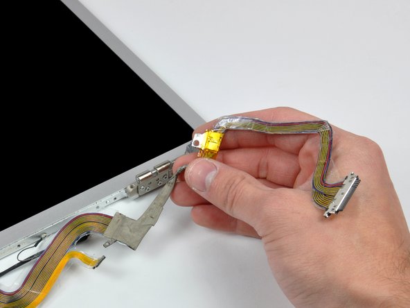

Add Note Edit Step 36 — Display Data Cable  ¶
  • De-route the display data cable from around the right clutch hinge and remove it from the front bezel.

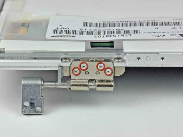

Add Note Edit Step 37 — Right Clutch Hinge  ¶
  • Remove the four T6 Torx screws securing the right clutch hinge to the front display bezel.
Image #1

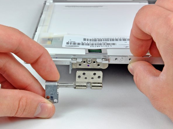

Add Note Edit Step 38  ¶
  • Remove the right clutch hinge from the front display bezel.
