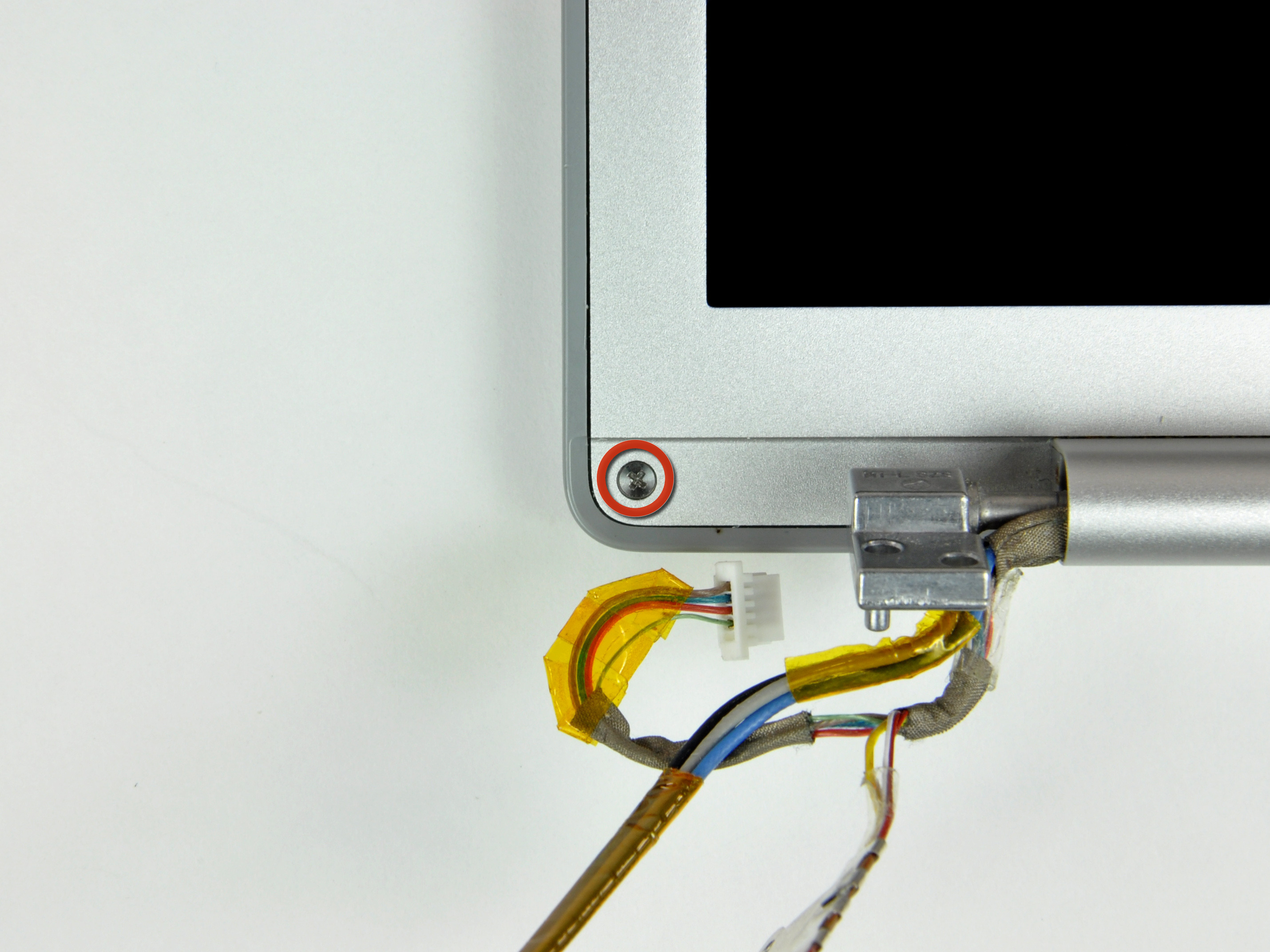

Remove the rear display bezel to access most of your display's internals.
Image #1 Image #2
