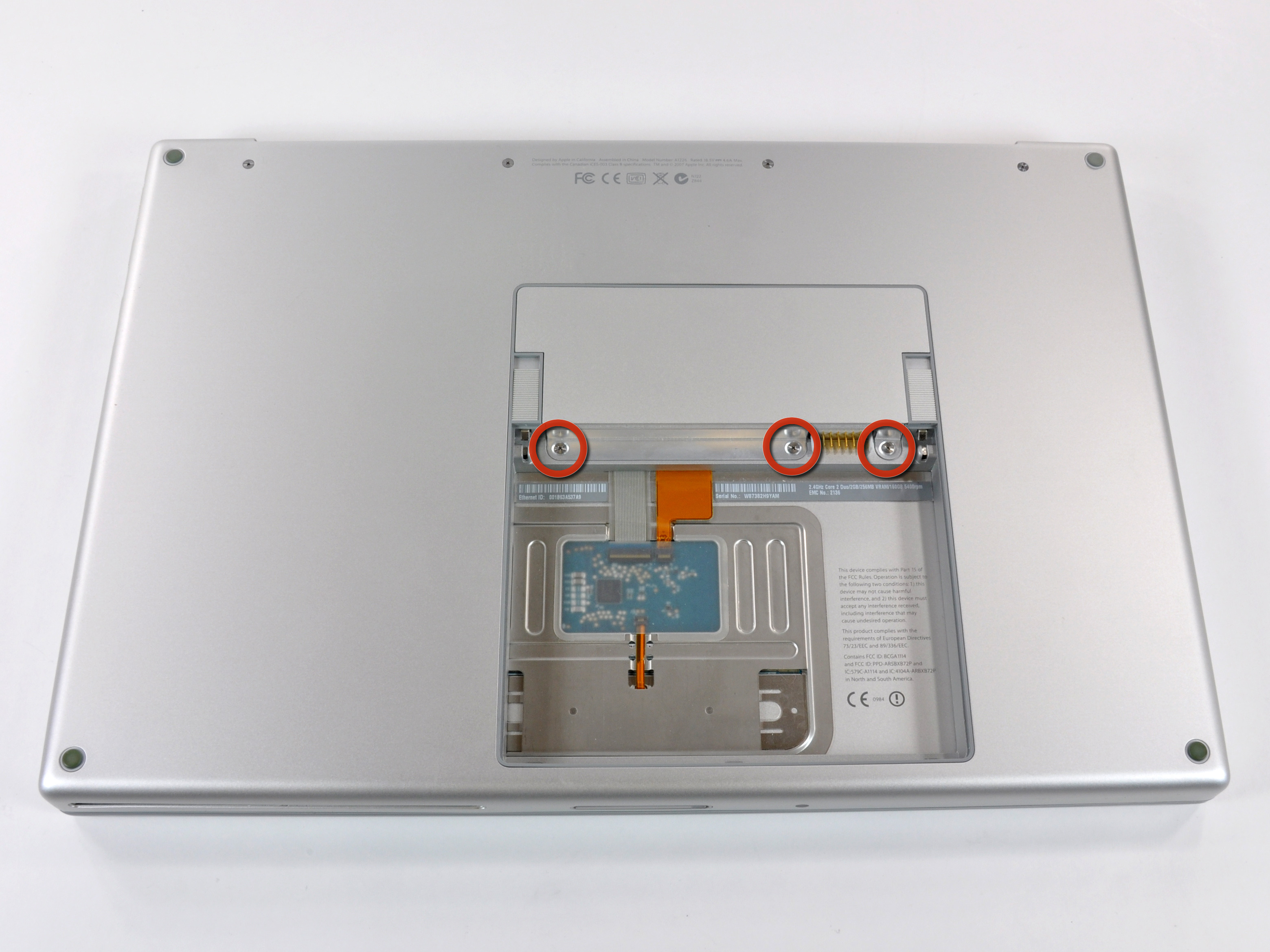

Removing a few screws will remove this part and allow access to your RAM.
Image #1 Image #2
  • Use your fingers to push both battery release tabs away from the battery, and lift the battery out of the computer.
Image #1 Image #2
Add Note Edit Step 2 — RAM Shield  ¶
  • Remove the three identical 2mm Phillips screws from the memory door.
  • Lift the memory door up enough to grip it and slide it toward you, pulling it away from the casing.
