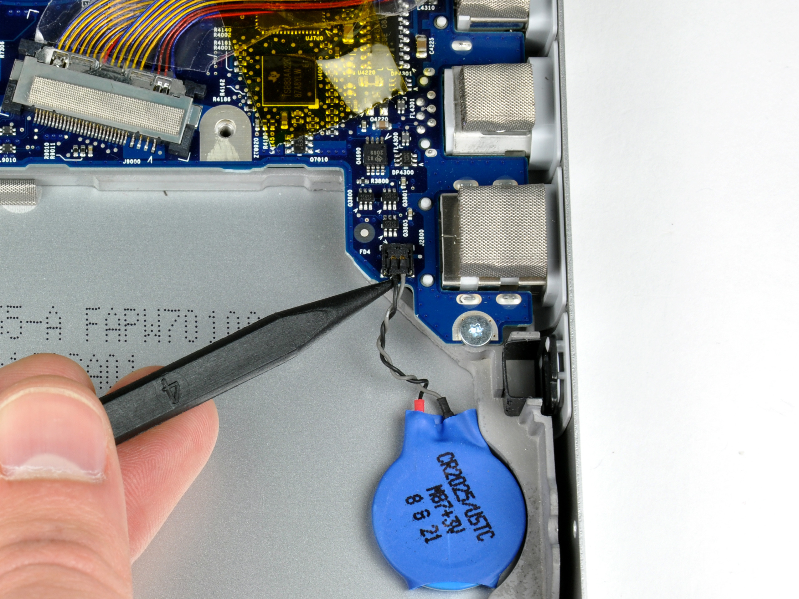

  12. MacBook Pro 15" Core 2 Duo Models A1226 and A1260 PRAM Battery Replacement, PRAM Battery: step 12, image 1 of 2 MacBook Pro 15" Core 2 Duo Models A1226 and A1260 PRAM Battery Replacement, PRAM Battery: step 12, image 2 of 2
    • Disconnect the PRAM battery cable from the bottom right corner of the logic board.
    • Use a spudger to pry up the PRAM battery from the lower case.
    • Lift the PRAM battery out of the computer.
