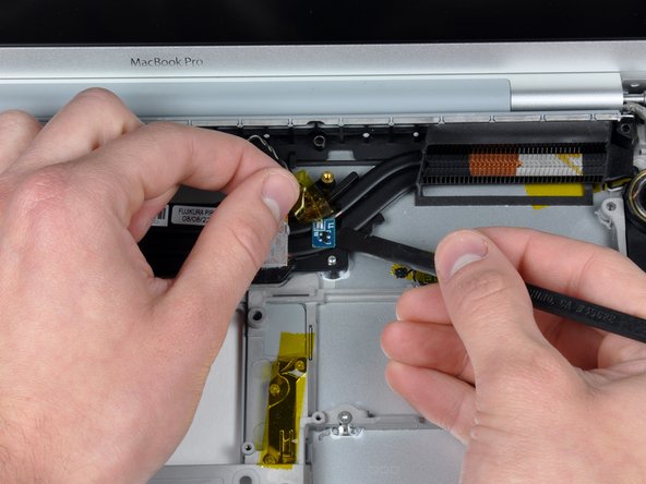

Add Note Edit Step 22 — Middle Thermal Sensor  ¶
  • Peel back the orange Kapton tape covering the middle thermal sensor.
  • Use a spudger to pry the middle thermal sensor off the heat sink.
