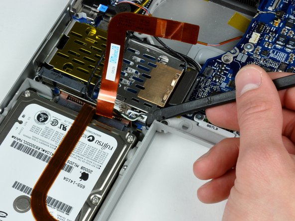

Add Note Edit Step 13 — ExpressCard Cage  ¶
  • Disconnect the hard drive and ExpressCard connectors from the left side of the logic board.
Image #1

  • Peel up the orange hard drive cable from above the ExpressCard cage.
Image #1 Image #2

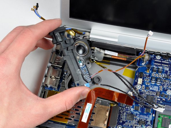

Add Note Edit Step 17  ¶
  • Use a spudger to disconnect the speaker cable from the corner of the left I/O board.
  • Lift the left speaker assembly out of its housing and place it in the area previously occupied by the left fan.
Image #1

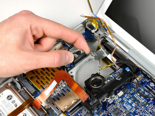

Add Note Edit Step 18  ¶
  • Disconnect the large gray and black power cable from the left I/O board.
Image #1

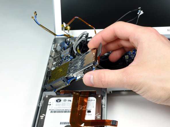

Add Note Edit Step 19  ¶
  • Use a spudger to disconnect the inverter cable from the corner of the left I/O board.
Image #1 Image #2
Add Note Edit Step 20  ¶
  • Remove the following 5 screws/standoffs:
    • Four black 4 mm T6 Torx screws securing the left I/O board to the lower case.
    • One 4 mm standoff located between the audio jacks.
  • Lift up the right side of the left I/O board and slide it out of the computer.
Image #1 Image #2

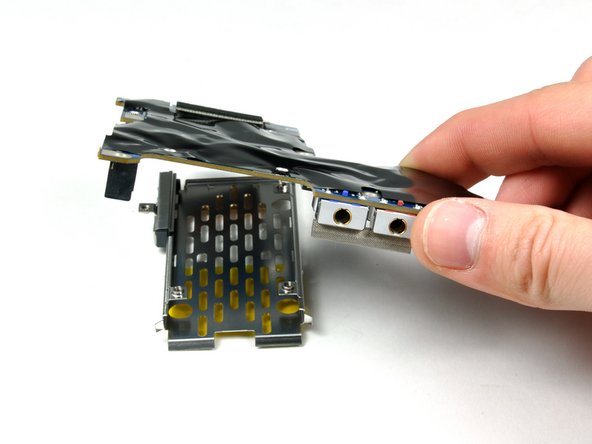

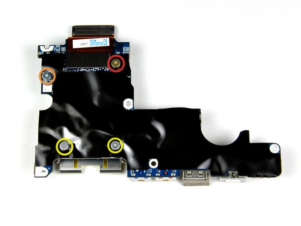

Add Note Edit Step 21  ¶
  • Remove the following four screws:
    • One 3.1 mm at upper right.
    • One 4.9 mm at upper left.
    • Two 2.2 mm along the bottom.
  • Lift the left I/O board off the ExpressCard cage.

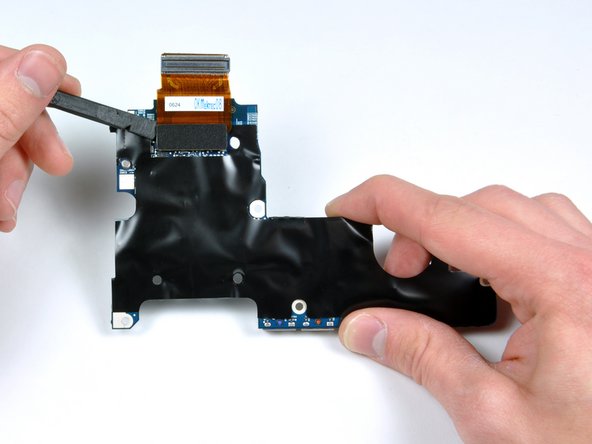

Add Note Edit Step 22 — Left I/O Board  ¶
  • Disconnect the short left I/O board cable.
  • Left I/O board remains.
