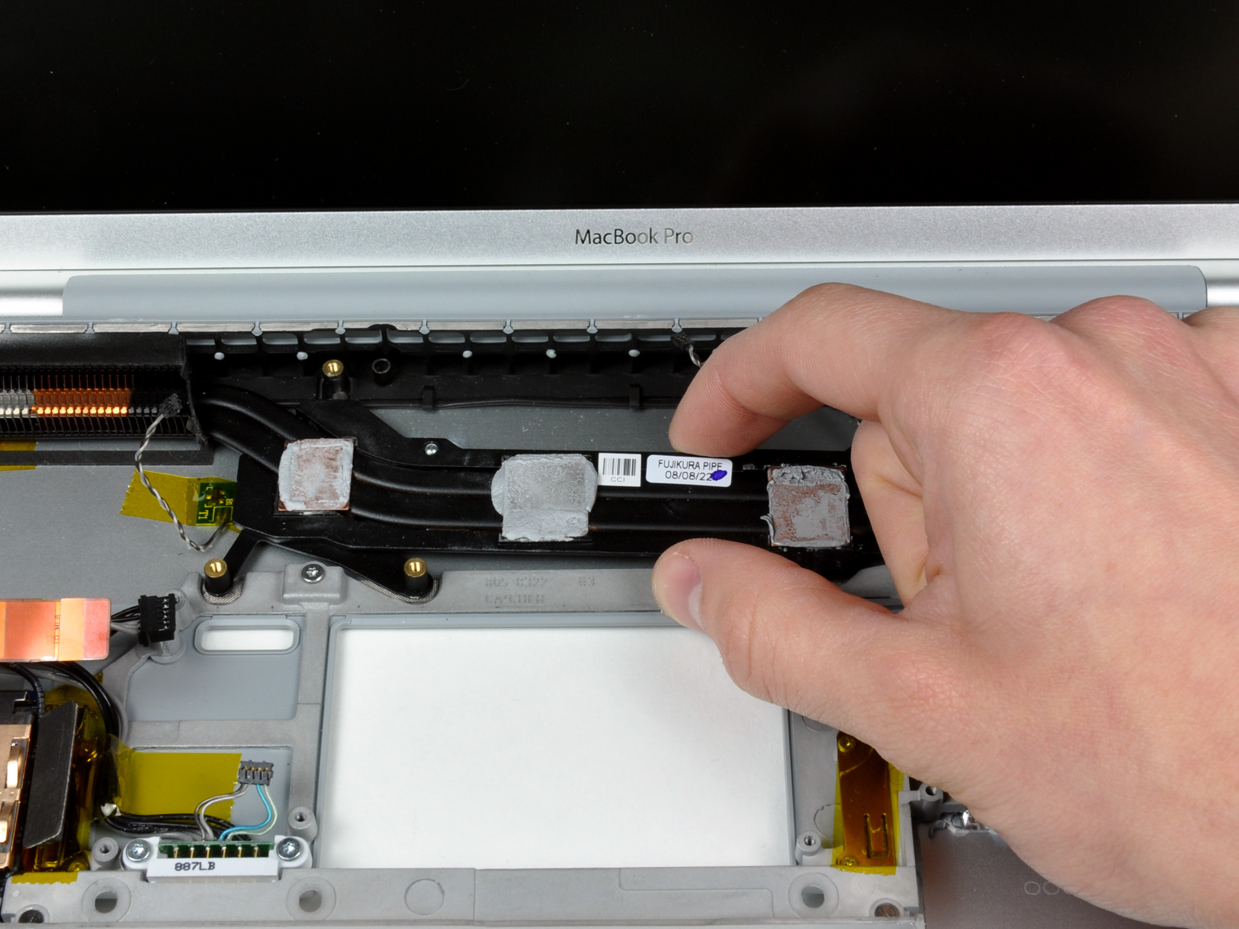

Gently lift the heat sink out of the computer.
Peel back the orange Kapton tape covering the middle thermal sensor.
Use a spudger to pry the middle thermal sensor off the heat sink.
Heat sink remains.
