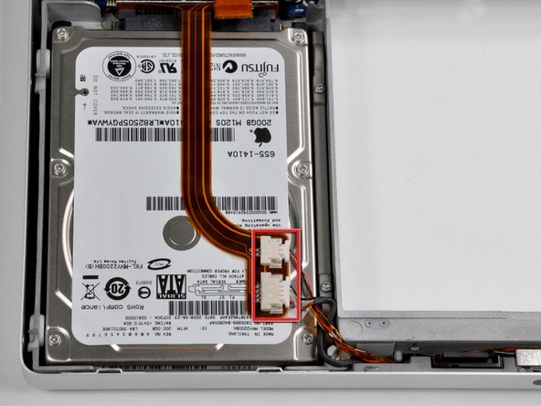

Add Note Edit Step 11  ¶
  • Disconnect the sleep light and IR sensor connectors from the ribbon cable on top of the hard drive.
Image #1

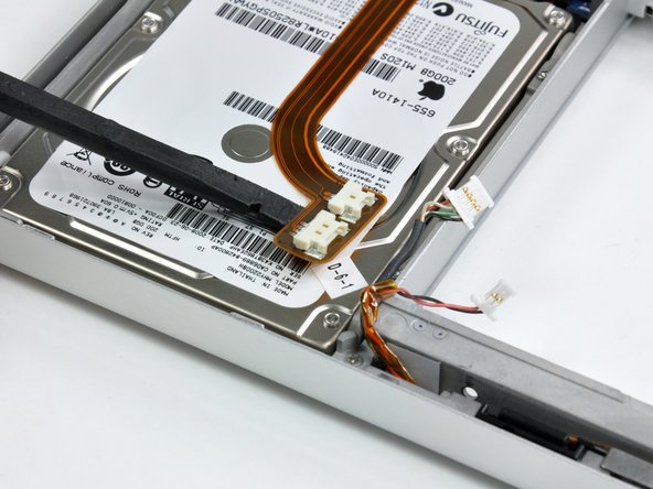

Add Note Edit Step 12  ¶
  • Using a spudger, carefully loosen the adhesive holding the ribbon cable to the surface of the hard drive.
Image #1

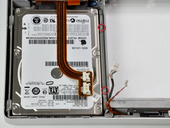

Add Note Edit Step 13  ¶
  • Remove the two silver Torx screws securing the hard drive bracket to the lower case.
Image #1

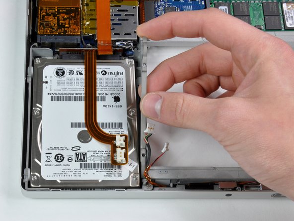

Add Note Edit Step 14  ¶
  • Remove the hard drive bracket from the lower case.
Image #1

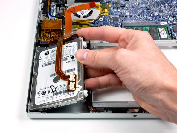

Add Note Edit Step 15  ¶
  • Lift the hard drive from the right side and pull it up and out of the lower case.
Image #1

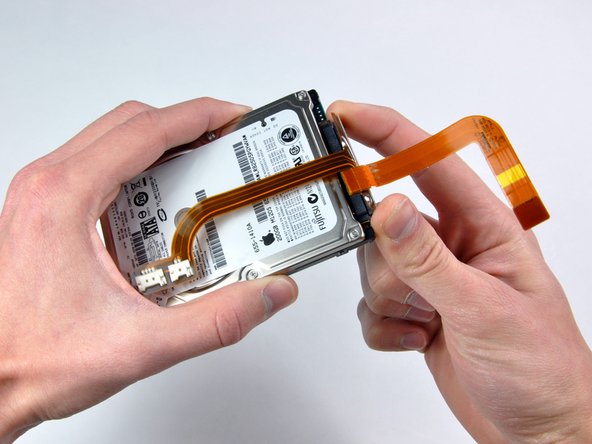

Add Note Edit Step 16  ¶
  • Disconnect the hard drive cable from the rear of the hard drive.
  • Hard drive cable remains.
