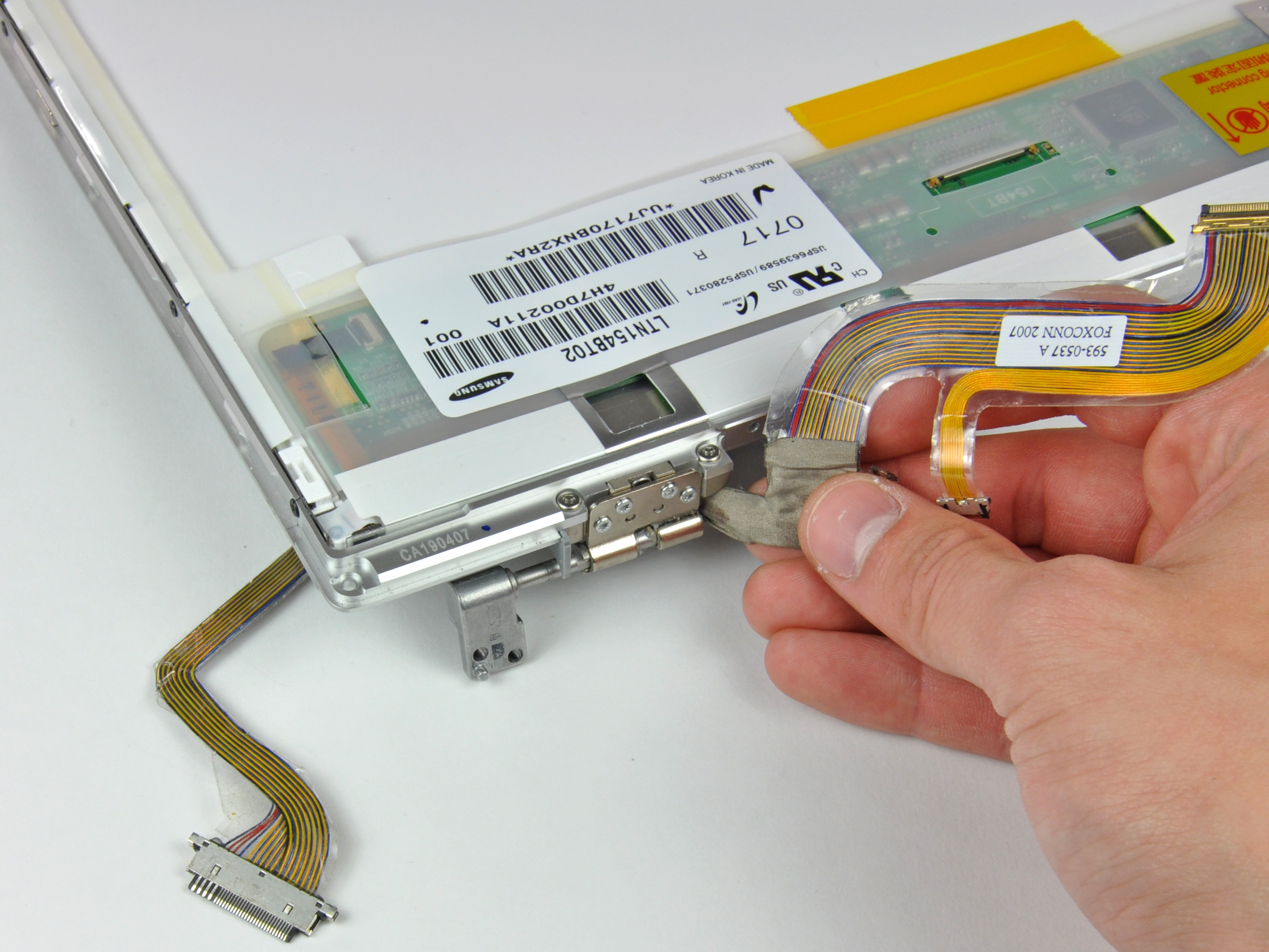

Use this guide to replace a fatigued front display bezel.
Image #1 Image #2
  • Use your fingers to push both battery release tabs away from the battery, and lift the battery out of the computer.
Image #1 Image #2
Add Note Edit Step 2 — RAM Shield  ¶
  • Remove the three identical 2mm Phillips screws from the memory door.
  • Lift the memory door up enough to grip it and slide it toward you, pulling it away from the casing.
Image #1
Add Note Edit Step 3 — Upper Case  ¶
  • Remove the two 2.8 mm Phillips screws in the battery compartment near the latch.
Image #1
Add Note Edit Step 4  ¶
  • Remove the following 6 screws:
    • Two 10 mm T6 Torx screws on either side of the RAM slot.
    • Four 14.5 mm Phillips screws along the hinge.
Image #1
Add Note Edit Step 5  ¶
  • Remove the four 3.2 mm Phillips screws on the port side of the computer.
Image #1
Add Note Edit Step 6  ¶
  • Rotate the computer 90 degrees and remove the two 3.2 mm Phillips screws from the rear of the computer.
Image #1
Add Note Edit Step 7  ¶
  • Rotate the computer 90 degrees again and remove the four 3.2 mm Phillips screws from the side of the computer.
Image #1 Image #2 Image #3
Add Note Edit Step 8  ¶
  • Do not yank the upper case off quickly. The case is attached to the logic board via a ribbon cable.
  • Lift up at the rear of the case and work your fingers along the sides, freeing the case as you go. Once you have freed the sides, you may need to rock the case up and down to free the front of the upper case.
  • There are four plastic clips above the DVD slot, and another above and to the left of the IR sensor. These clips can be very difficult to disengage without prying. They can also be difficult to re-engage during reassembly.
  • Reassembly Tip: Press down firmly on the tip of the top case above the location of each clip until you hear a snap to reseat them in their slots.
  • Reassembly Tip: The two center DVD clips will rarely snap back into place properly without help, and downward pressure will instead simply deform the frame around the DVD slot. Support the frame by inserting a plastic spudger into the DVD slot directly under the clip location until it is snug, then press down until you hear the snap.
