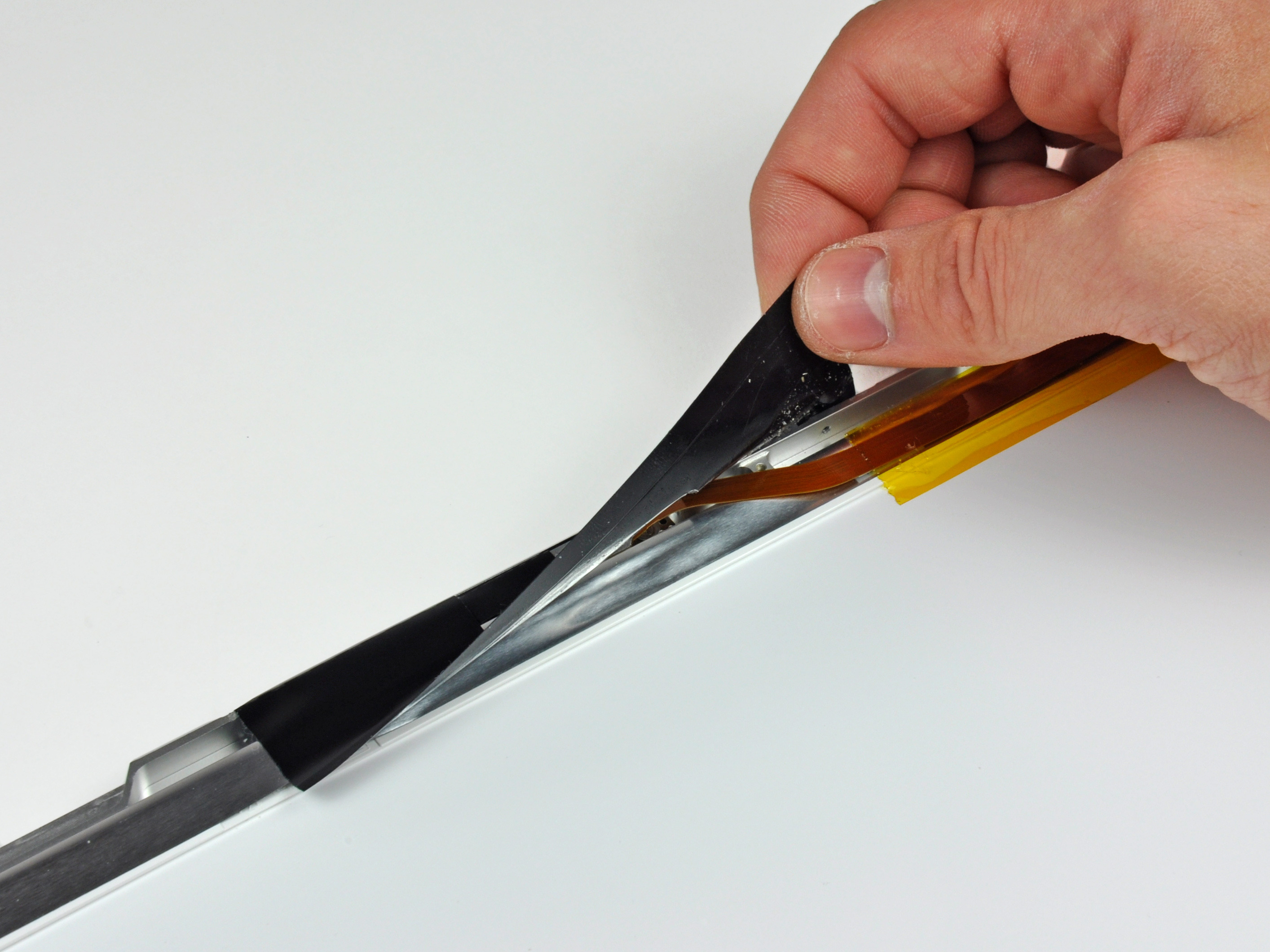

    • Peel the large piece of tape near the display latch off the top edge of the LCD.
    • It is not necessary to completely remove this piece of tape.
  27. MacBook Pro 15" Core 2 Duo Models A1226 and A1260 Camera Board Replacement: step 27, image 1 of 1
    • Remove the two pieces of tape covering the camera cable.
    • Hold the camera cable down while removing the tape.
