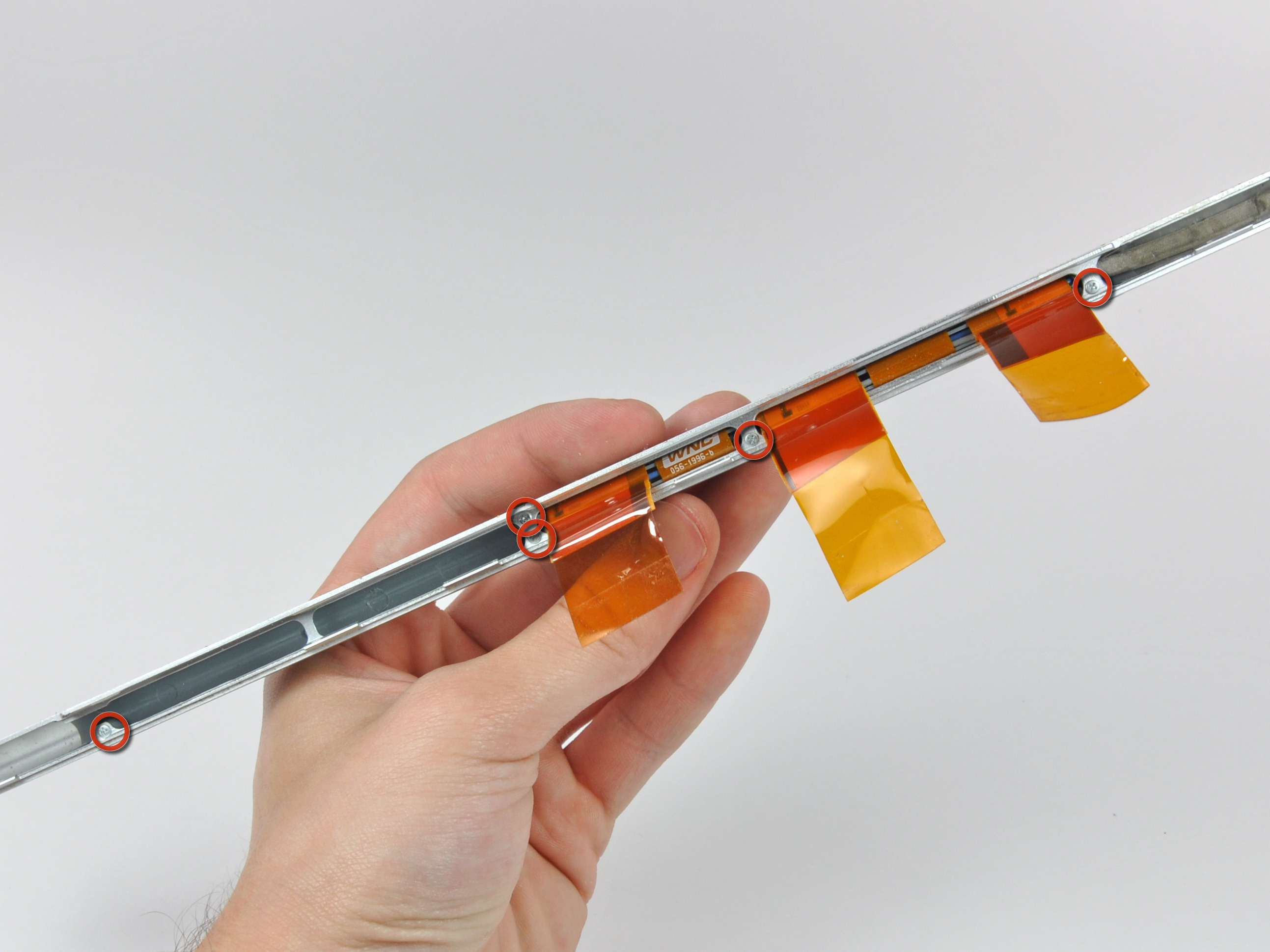

Installing MacBook Pro 15" Core 2 Duo Models A1226 and A1260 Antenna Cover
  • Add Note x
  • x 5
Replace a cosmetically damaged antenna cover with this guide.
