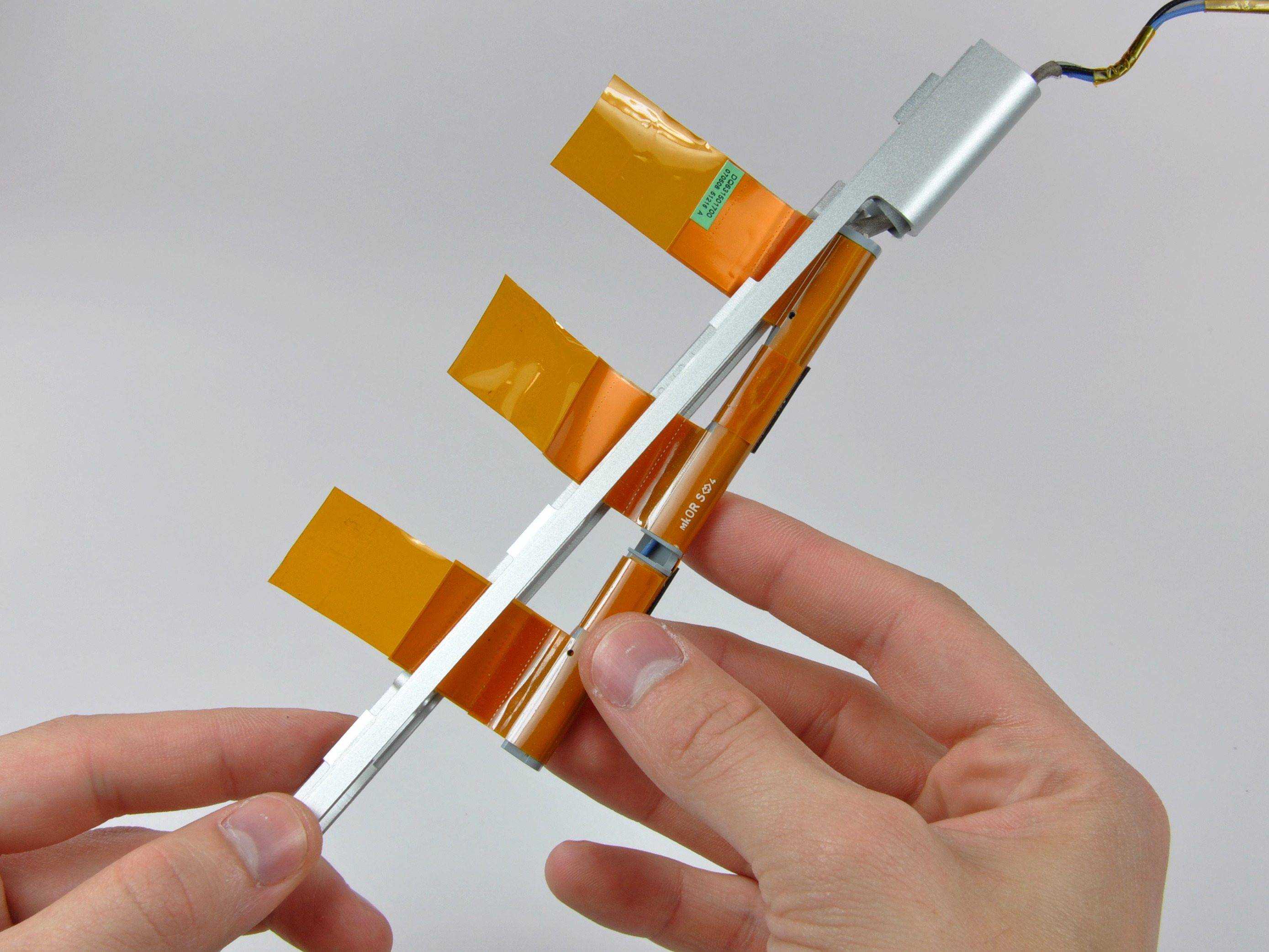

  36. MacBook Pro 15" Core 2 Duo Models A1226 and A1260 Antenna Cables Replacement, Antenna Cover: step 36, image 1 of 1
    • Remove the five small Phillips screws securing the plastic antenna cover to the inside of the clutch cover.
  37. MacBook Pro 15" Core 2 Duo Models A1226 and A1260 Antenna Cables Replacement: step 37, image 1 of 1
    • Pull the antenna cover off the clutch cover, being careful not to damage the antenna cables.
  38. MacBook Pro 15" Core 2 Duo Models A1226 and A1260 Antenna Cables Replacement, Antenna Cables: step 38, image 1 of 1
    • If necessary, peel the antenna leads off the adhesive securing them to the clutch cover.
    • Remove the antenna cables from the clutch cover, being careful not to damage the three antenna straps.
  39. MacBook Pro 15" Core 2 Duo Models A1226 and A1260 Antenna Cables Replacement: step 39, image 1 of 1
