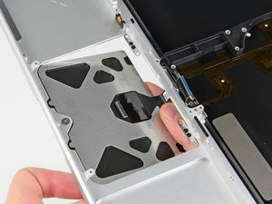

Carefully insert the cable from your old trackpad through its slot cut into your new upper case.
Use one hand to hold the trackpad cable in place as you insert the two retaining tabs on the outer edge of the trackpad under the lip on the upper case.
Pull the trackpad cable as you seat the trackpad into its void in your new upper case.
Tighten the outer two screws along the inner edge of the trackpad and check the alignment of it on the outer side of the upper case.
If its alignment looks good, install the rest of the Phillips screws along the inner edge of the trackpad.
Before reassembling your machine, verify that the set screw is still installed in a position so the mouse will click correctly.
