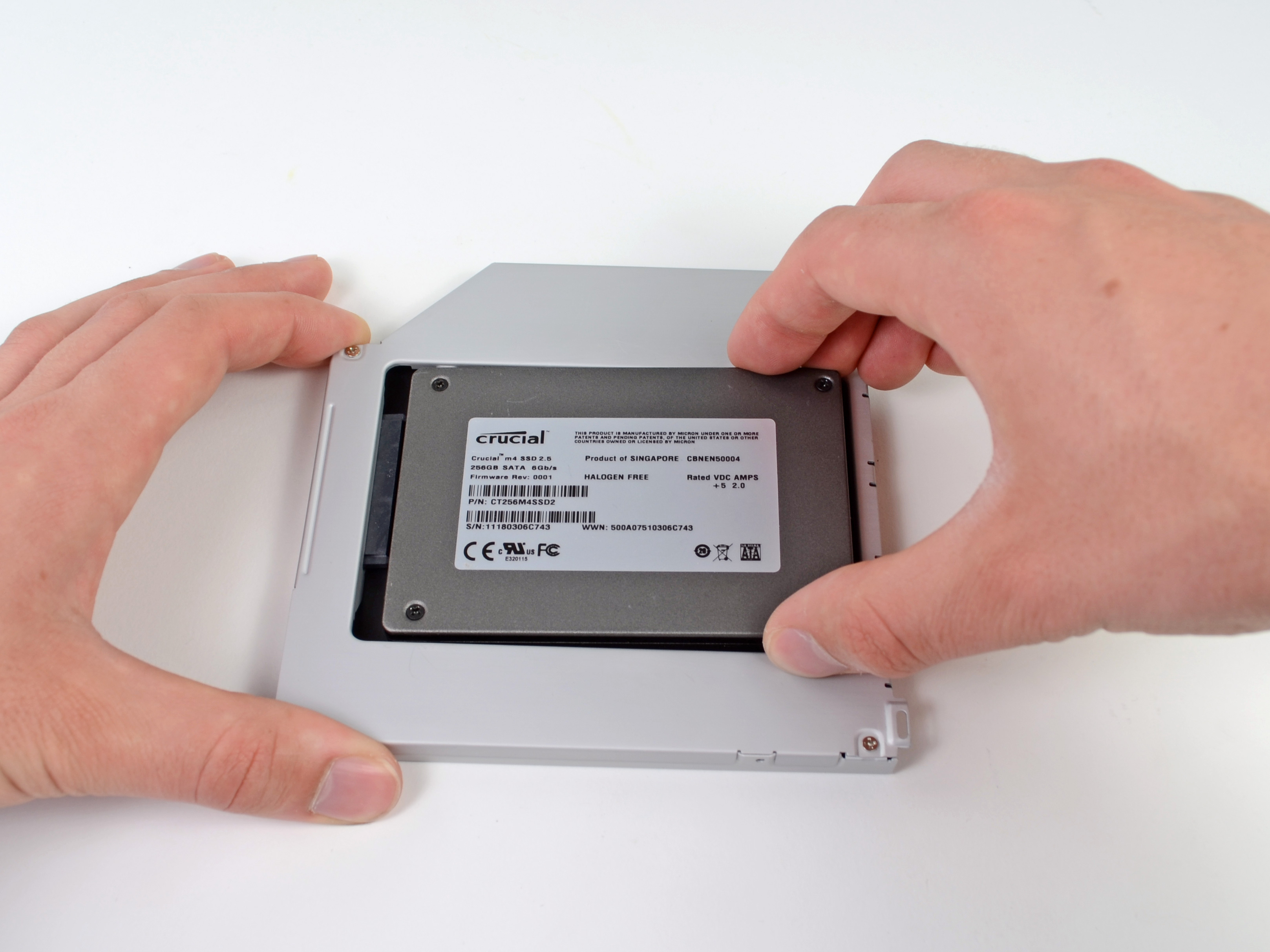

Add Note Edit Step 14 — Dual Hard Drive  ¶
  • Remove the plastic spacer from the optical bay hard drive enclosure by pressing in on one of the clips on either side and lifting it up and out of the enclosure.
Image #1 Image #2 Image #3
Add Note Edit Step 15  ¶
  • Make sure that the hard drive connectors are facing down before placing it into the enclosure.
  • Gently place the hard drive into the enclosure's hard drive slot.
  • While firmly holding the enclosure in place with one hand, use your other hard to press the hard drive into the enclosure connectors.
Image #1 Image #2
Add Note Edit Step 16  ¶
  • Once the hard drive is snug, reinsert the plastic spacer while holding the hard drive against the bottom of the enclosure.
Image #1 Image #2
