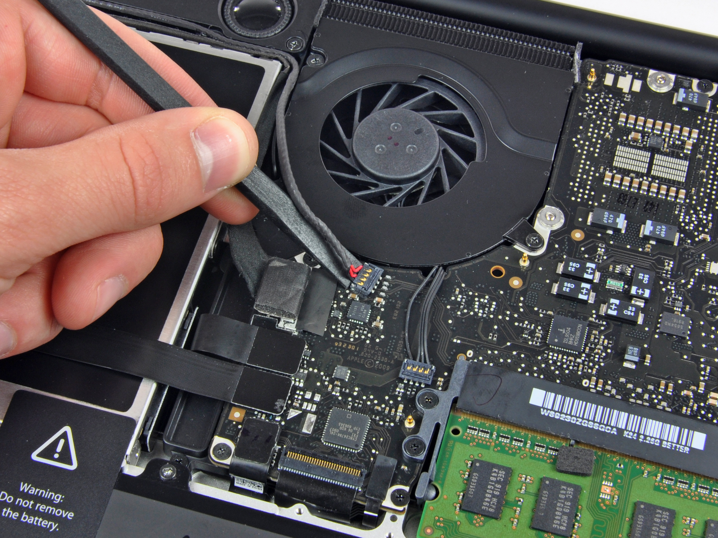

Image #1 Image #2
Add Note Edit Step 9  ¶
  • Remove the following two screws securing the display data cable bracket to the upper case:
    • One 7 mm Phillips screw.
    • One 5 mm Phillips screw.
  • Lift the display data cable bracket out of the upper case.
Image #1 Image #2
Add Note Edit Step 10  ¶
  • Remove the two outer 6.5 mm Torx screws securing each of the two display brackets to the upper case (4 screws total).
Image #1
Add Note Edit Step 11  ¶
  • Open your MacBook so the display is perpendicular to the upper case.
  • Place your opened MacBook on a table as pictured.
  • While holding the display and upper case together with your left hand, remove the remaining 6.5 mm Torx screw from the lower display bracket.
Image #1
Add Note Edit Step 12  ¶
  • Be sure to hold the display and upper case together with your left hand. Failure to do so may cause the freed display/upper case to fall, potentially damaging each component.
  • Remove the last remaining 6 mm T6 Torx screw securing the display to the upper case.
Image #1 Image #2
Add Note Edit Step 13  ¶
  • Grab the upper case with your right hand and rotate it slightly toward the top of the display so the upper display bracket clears the edge of the upper case.
  • Rotate the display slightly away from the upper case.
Image #1
Add Note Edit Step 14  ¶
  • Lift the display up and away from the upper case, minding any brackets or cables that may get caught.
Next » « Previous
