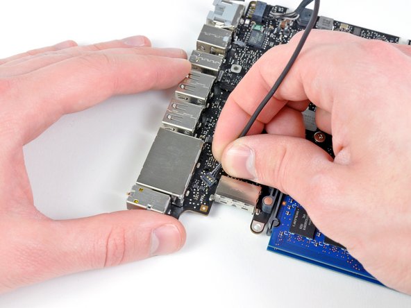

Add Note Edit Step 25  ¶
  • Pull the microphone cable upward to lift its connector out of the socket on the logic board.
  • Remove the microphone.

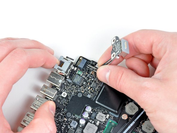

Add Note Edit Step 26  ¶
  • Pull the MagSafe DC-In board cable toward the heat sink to disconnect it from the logic board.
  • Remove the DC-In board.

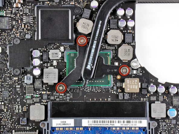

Add Note Edit Step 27  ¶
  • Remove the three 8.4 mm #1 Phillips screws securing the heat sink to the logic board.
  • Don't lose the springs held under each of the screws.
  • Carefully remove the heat sink from the processor.
  • If the heat sink seems to be stuck, it may be helpful to gently pry it off the processor with a plastic spudger. Be careful not to break any surface mount components on the processor while prying.
  • Be sure to clean off the old thermal paste and apply a new layer before you reinstall the heat sink. We have a guide that makes it easy.

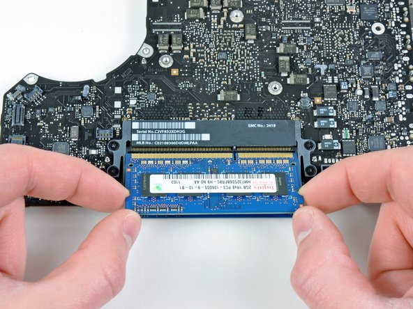

Image #1 Image #2
Add Note Edit Step 28  ¶
  • Pull the two RAM retaining arms away from the center of the RAM chip.
  • The RAM chip should "pop" up slightly from its socket.
  • Pull the RAM stick out of its socket.
  • Repeat this process to remove the second RAM chip.
  • Logic board remains.
