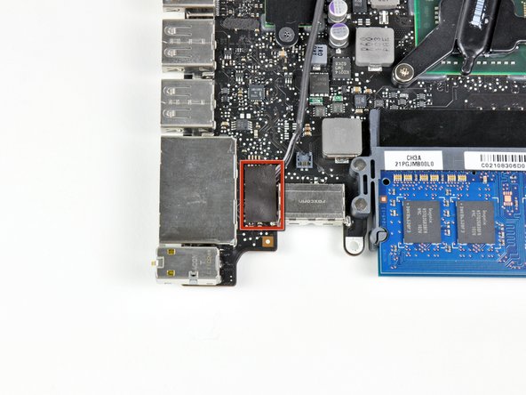

  • Remove the small piece of black tape covering the left speaker connector.
Image #1

  • Remove the piece of black tape covering the microphone connector.
Image #1
