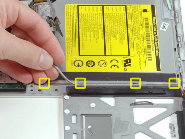

  • Lift the front edge of the optical drive and slide it up and out of the computer.
Image #1 Image #2
Add Note Edit Step 24 — Optical Drive Bezel  ¶

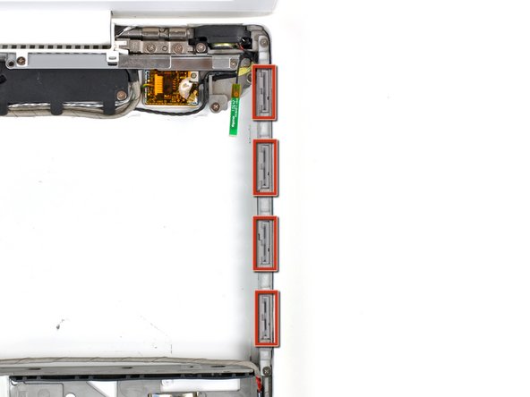

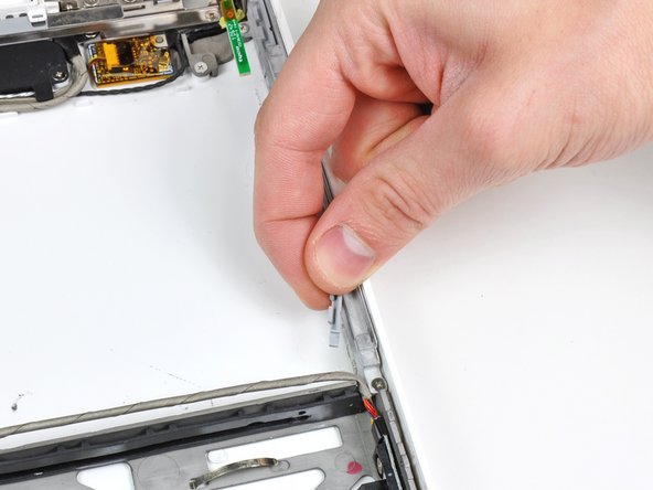

  • There are four plastic upper case clips installed in the aluminum framework above the optical drive opening. It is recommended to remove these clips before attempting to remove the optical drive bezel.
  • To remove the clips, simply slide them out of the aluminum framework away from the side of the lower case.
Image #1

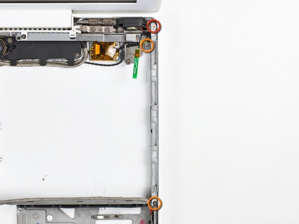

  • Remove the following three #00 screws:
    • One 5.7 mm Phillips screw
    • Two 3.1 mm Phillips screws
Image #1

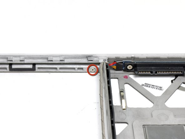

Add Note Edit Step 26  ¶
  • Remove the single 3.1 mm Phillips screw below the inside of the optical drive opening.
Image #1 Image #2

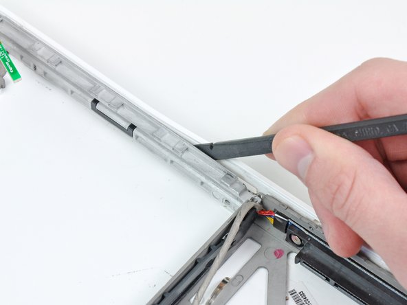

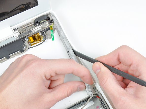

  • Insert the flat end of a spudger between the optical drive bezel and the plastic lower case.
  • Gently pry the optical drive bezel away from the adhesive securing it to the lower case enough to lift the mounting ear near the hard drive connector above the metal framework.

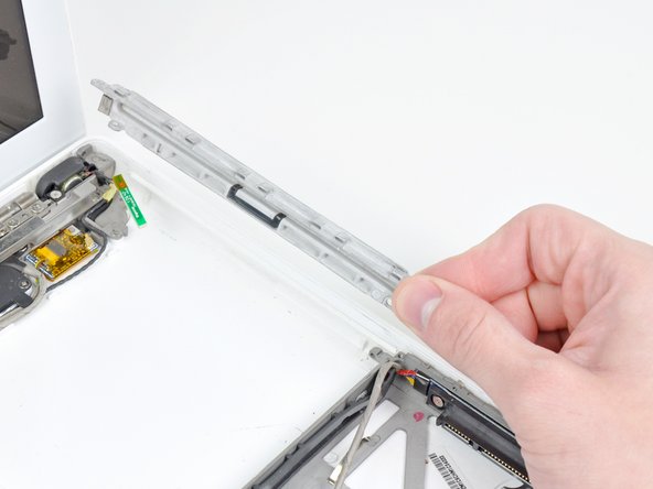

  • Lift the optical drive bezel enough to clear the metal framework and continue separating it from the lower case with your spudger.
Image #1
Add Note Edit Step 28  ¶
  • Remove the optical drive bezel from the lower case.
