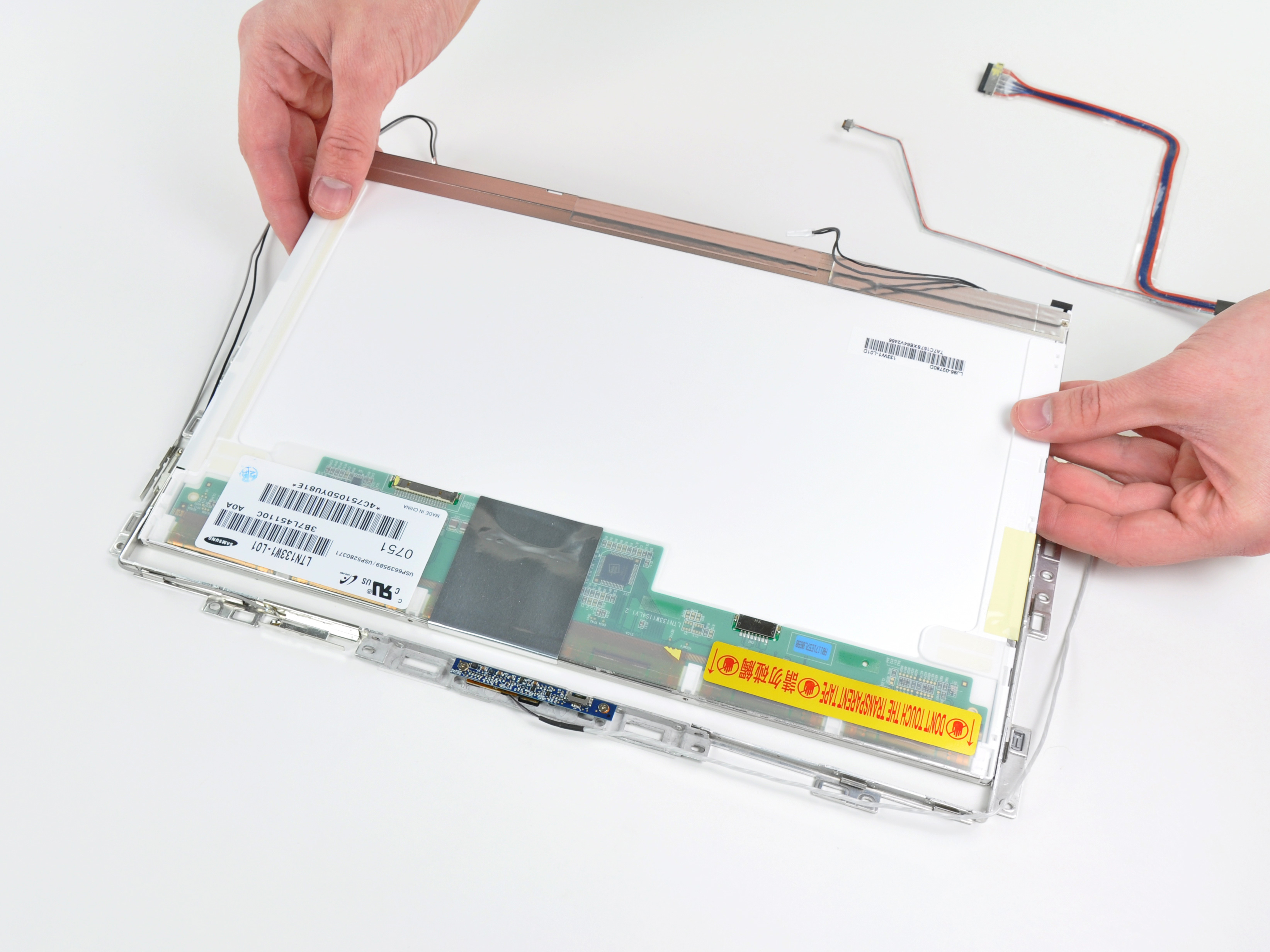

Image #1
Add Note Edit Step 57  ¶
  • Remove the three 3.1 mm Phillips screws along the left edge of the display.
Image #1
Add Note Edit Step 58  ¶
  • Remove the two 3.1 mm Phillips screws securing the iSight holder to the top of the display.
  • Make sure to remove the screws securing the metal bracket to the edge of the display and not the screws in the iSight board itself.
Image #1
Add Note Edit Step 59  ¶
  • Remove the three 3.1 mm Phillips screws along the right edge of the display.
Image #1
Add Note Edit Step 60  ¶
  • Lift up the LCD panel by its bottom edge and slide it out of the metal mounting brackets.
